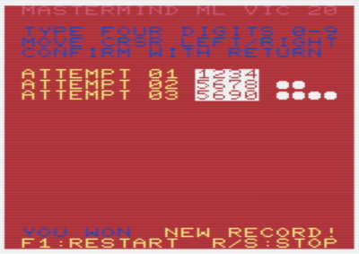

Mike wrote: Wed Jan 26, 2022 10:41 am Sarebbe molto interessante vedere sia il programma originale che la traduzione in linguaggio macchina.
See attachs: a zipped file with my original written in BASIC, and a quite different version in ML (with 2-pass listing).
BASIC version is not important for me. The hard work is for assembly version :)
Please don't be too bad in your judgment :)
mmml-fraural.zip
For testing purposes
(25.94 KiB) Downloaded 306 times
Re: Linguaggio macchina VIC20
It's like Wordle, but with numbers! :D
I keep getting it in 6 guesses, and that's my record.
You can't judge something too harshly if it works! You can start learning techniques to be more efficient (with memory and cycles) a little at a time. It depends on what your priorities are. One simple technique: don't be afraid of inlining your code. If you're only using a subroutine once (like most of the stuff in START, RESTART, MAINLOOP) it saves both bytes and cycles to just move that subroutine code right to the main process. When you program in other languages, this can seem strange. And I don't always heed this advice myself, because old C habits can prevail. But it's a good place to start.
Nice job!
One suggestion I have is to use a third character (like X) when the number is a miss. Otherwise, it's hard to tell (especially in early games) which position the output refers to.
I'm getting it in 3 or 4 almost every game now, with the occasional 5.

chysn wrote: Fri Jan 28, 2022 8:21 am One suggestion I have is to use a third character (like X)
Yes, it had occurred to me too.
Thanks for wasting your time with this exercise ;)
