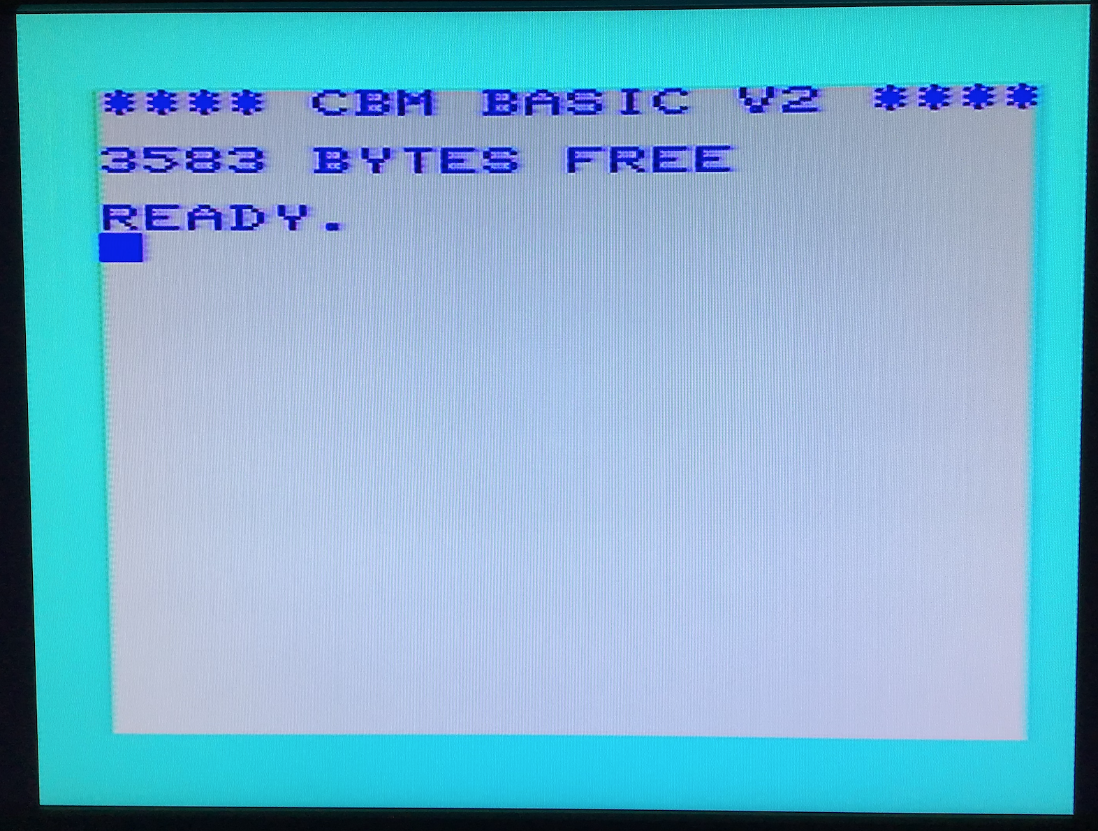

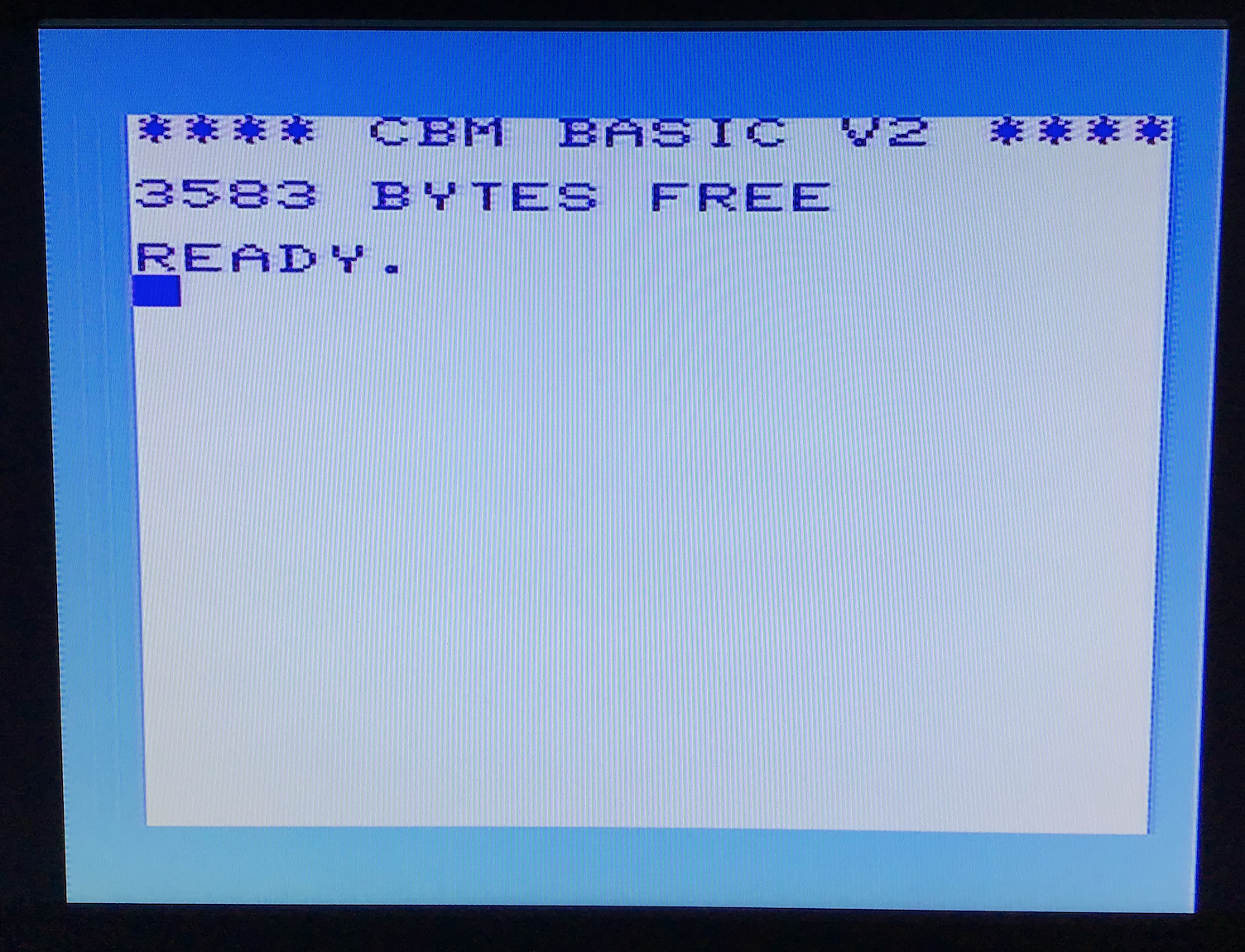

Sorry, I forgot. Also, my iPad seems to hate my CRT. I'll try to take some better pictures on an LCD. Also, maybe turquoise is a better term?
chysn wrote: Mon Jan 04, 2021 10:42 am When I was ten years old, upon learning the colors available with CTRL 1~8, I did not know what "cyan" was. It's simply a color that I'd never heard of. On my TV, it looked light blue, so I spent pretty much all of my life thinking that cyan is light blue, what I thought of as "sky blue." Over the years, I had a lot of TVs and several (like six) NTSC VIC-20s, and the color of the cyan was consistent, or at least consistent enough not to challenge my perception of cyan as "another word for sky blue."
When I got my CR (NTSC) VIC-20 about a year ago, and set the controls on my 1702 to their detented positions, the border looks just like VICE. The sky blue of my childhood can be achieved by slightly increasing TINT, but this comes at the expense of an attractive purple.
All this is to say that I suspect there were variations over time. My current VIC-20 is the only CR VIC I've owned. I never had a 1702 when I was a kid, only TVs. But the difference between cyan and cerulean is the tiniest of knob flicks, and we can never trust our memories.
Thanks for this! You're the first to convey a similar experience to what I'm seeing. The fact that your current VIC-20 is a CR supports my change in manufacturing theory since the VIC in it was likely manufactured after 1982.
Update: New Photos. My iPad likes my LCD better. :)
The camera seems to make the blue text more vibrant in the second photo, but it looks the same in person.

r.cade wrote: Wed Jan 06, 2021 4:19 pm Mine has always been like your last photo, with a green tint. That's why I was confused by your question. CYAN is not like teal - it has more blue in it than teal, but there is green in it.
Sorry for the confusion. Up to this point, the only times I've seen the color cyan labeled was on printer ink cartridges. Very much the light blue color seen on the top screen as opposed to the (I'll say) "turquoise" color of the bottom.

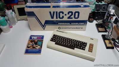

I bought my VIC pretty early on I think. I paid the original full price for it. It had the two prong power supply and came in the plain blue and white box like this one:
I still have the manual that came with it and it has the blue cover like the one in the picture and is apparently a first edition since it doesn't have any editions or printings indicated inside the front cover. The copyright date is 1981.
I don't know how closely that might date it but I hope it helps.
