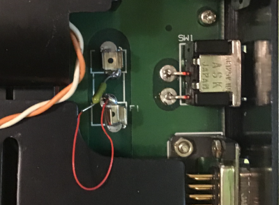

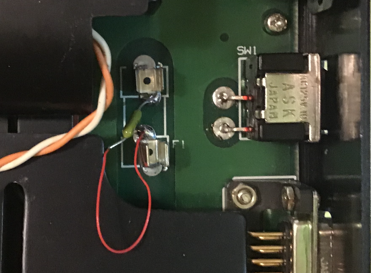

So I recently got this motherboard for an early (assuming due to the glass capacitors) two-prong VIC-20. I was told it works (at least it would if it were populated with all its missing IC's) with the exception of a bad power switch. I've repaired the switch (just some gummed up flux that was sticking it a bit in the off position), but there seems to be a modification on it where the fuse goes. A small red wire with what appears to be a green capacitor has been used to bridge the connection.
My questions on this are: Is this safe or should I remove it and put a fuse? If it is safe, then is it better than the fuse? And if so, would there be any serious benefit to doing a similar mod to my other VIC-20?

It might be some form of thermal fuse, for safety I would replace it with the correctly rated fuse.DistantStar001 wrote: ↑Tue Dec 22, 2020 1:04 am My questions on this are: Is this safe or should I remove it and put a fuse? If it is safe, then is it better than the fuse? And if so, would there be any serious benefit to doing a similar mod to my other VIC-20?

Not a problem. Also, I'm guessing that I should leave my other VIC the way it is.

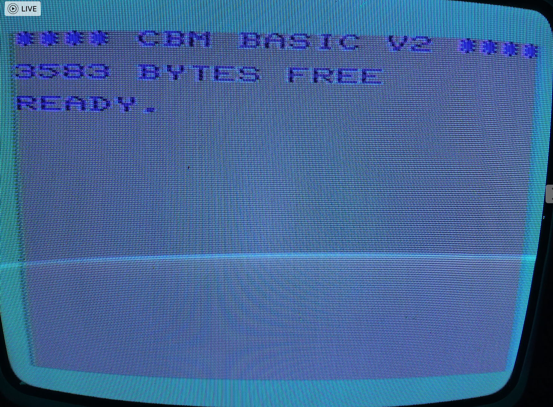

So I've run into an interesting... not quite problem... More like a difference, and I'm not quite sure which is correct.
I got a new (old stock) VIC chip and installed it, and yesterday I stopped by my local electronic recycler where they happened to have a VIC-20 for sale. I bought it figuring that I could use it to swap chips without risking damage to my PET-style (really love that thing). I hooked it up, and it works perfectly. Then I temporarily transplanted the ROMs to test to see if my motherboard really was fully functional. The good news is that it works. However, the border color is different than my other two VIC's. More greenish, where the other two are very blue. The thing is that the color seems closer to what I see in YouTube videos of other VIC-20's and on VICE. On the other hand, the two VIC's that I have both display the blue border.
Pictures are below. Maybe someone can clue me in as to which is correct, and how to adjust it? By the way. The lack of a cursor on the third screen is related to the current lack of VIA chips. I'll be getting them soon.
Re: VIC-20 Motherboard repair/questions/PAL conversion/IC population
The bottom picture looks more normal. There's a trimmer in the video circuit that can be adjusted.DistantStar001 wrote: ↑Thu Dec 24, 2020 8:06 pm Pictures are below. Maybe someone can clue me in as to which is correct, and how to adjust it?

OK! So an interesting discovery! Looking inside the video box, I found three trimming pots. Two plastic ones were housed with the VIC chip and one metal in the smaller compartment. Working from left to right, I tried adjusting each. The first seemed to affect the brightness of the picture, the second did nothing at all, and the metal one was sealed with wax. I broke the seal (can always reseal later) and got either color, monochrome or black screen depending on which way I turned it. However, there was no effect on the background color from any of the pots. So then I opened up my PET -style and started comparing date codes. Not surprising, the PET-style was from 1981, my other two are dated 1982. But the other computer has a VIC manufactured in the 32nd week of 82, where the VIC I got for the motherboard is from the 50th week. This made me think, maybe later VIC chips produce different colors? So I swapped them. Low and behold the green-teal screen followed the newer VIC!srowe wrote: ↑Fri Dec 25, 2020 3:14 amThe bottom picture looks more normal. There's a trimmer in the video circuit that can be adjusted.DistantStar001 wrote: ↑Thu Dec 24, 2020 8:06 pm Pictures are below. Maybe someone can clue me in as to which is correct, and how to adjust it?
So I'm guessing that there must have been a change in the manufacturing of VIC chips that occurred at some point before the 50th week of 1982.
