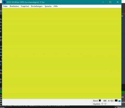

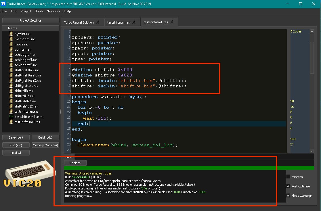

Re: how can you load trse data to $a000 without an array with poke or pointer?
data are same order wie the program data.bin >>>>not funktionYea, you can load data to $a000 at runtime. Use pointers but it is great with exomize to unpack data to
not funktion!!!!!
@define daten "$a000"
daten: incbin("daten.bin",@daten);
not funktion!!!!
zpdaten: pointer;
zpdaten:=@daten / zpdaten:=$a000
daten: incbin("daten.bin",^zpdaten);
daten: incbin("daten.bin",zpdaten);
$A000 is a space usually used for cartridge. I get same results with prg if I try to put data there.
I’m sure someone here can explain why, but I suspect you need to make a crt instead and put something the Vic expects in there.
As said, I used that space as ram at runtime without problems, but have to leave it empty in the PRG.
Probably need a Vic 20 expert to chime in, but I thought I'd try a simple program in CBM PRG Studio that can output to the Vic 20 with all 8K blocks enabled as RAM:
I get the same happening as I do with TRSE, the Vic 20 (in Vice) just hangs. It does not like any address in block 5 being occupied. This is also producing a PRG and passing that in to xvic so perhaps it is to do with that?
The only way to get the above to run is to remove *=$a000 or point it somewhere other than block 5. I can still write to address $a000 after the program has started but that is all I could get to work.
I don't know how you are doing it in BASIC or forth, sorry. Maybe someone on Denial will know the answer?
; 10 SYS8192
*=$1201
BYTE $0B, $12, $0A, $00, $9E, $38, $31, $39, $32, $00, $00, $00
*=$2000
lda test
lda test+1
rts
*=$a000
test byte $01,$02,$03,$04
