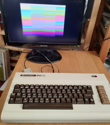

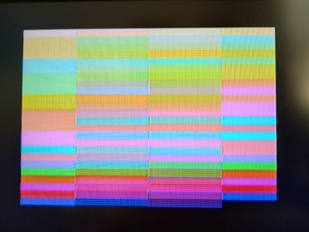

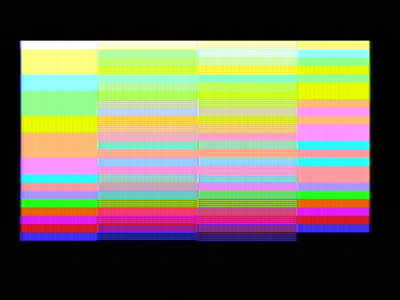

Program for unexpanded VIC20 at http://www.michiel.boland.org/vic20mix.zip
Output from VICE: Output from a real machine (do not have a CRT, well, not one that displays colors) detail view: Captures made by two separate capture cards this one appears to be a bit desaturated This appears to be a bit oversaturated, so the truth is probably somewhere in the middle.
The same card but with the comb filter disabled (i.e. no color averaging of subsequent lines)
Re: Request: PAL mixing test program
Cool, thanks, i added them to the testrepo. Also the odd/even lines seem to be correct in VICE. The colors themselves are still a bit off here and there... *sigh*

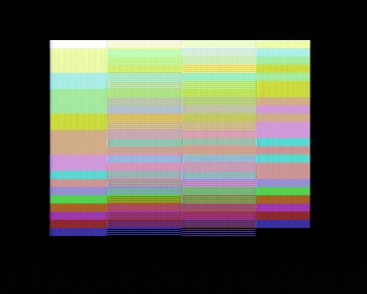

Here are two pics.
From my capture source, so it's probably the best one: From a camera pointed at my CRT, so it's hard to get it looking right:
