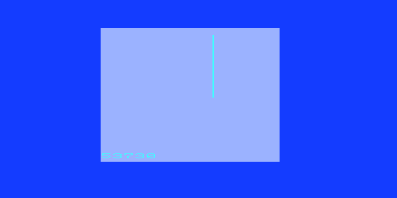

Hello,
I know my search for a quick Linde drawing code is a bit boring for some people. Nevertheless, I would like to share my latest optimization with you.
In the routine for creating the jumps in the main routine, I was able to get a small speed advantage by adjusting the BCS jump. It depends on whether the main direction of the line runs in X or Y. The routine then either jumps straight to the Y set point instruction or the X direction is recalculated.
The initialization routine starts at $2153 and the main line drawing routine at $0010.
Approximately 23-24,000 pixels per second are now drawn on a screen of 144x192 points.
The pixels per second are determined by the largest delta x or delta y and are counted per run.
(I used $59 for the counter, but i see, that it is possible to use $1B.)
The total is then displayed every second and then set to zero.
Hit Enter/Return to clear the screen.
If we have a screen with 128x192 points, up to 26,000 pixels per second are possible.
If you dont like to put the core line drawing routine to the ZP, you can modify the attached one easily.
On a 144x192 pixel screen, you have up to 22,000 pixels the second in a routine without the heavy ZP usage.
Are further optimizations possible in this small routine?
Best regards
Sven

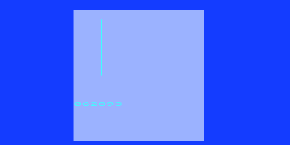

Hi,
here is a new version of my line routine.
The SEC can be deleted if only the major direction DEX or DEY is used.
Drawing the lines from right to left or from down to up.
DEX or DEY with CPX or CPY calculate the difference between Y or X and CPY or CPX >= 0 the carry was set.
https://www.c64-wiki.de/wiki/CPY_(RAUTE)$nn
This reduces the cycles in the ZP core routine by 2' cycles each pixel.
Here is the result on a 144x224 screen. The lines the are drawn on a 144x204 screen.
Line_without_SEC.zip
(10.35 KiB) Downloaded 104 times
MrSterlingBS
Posts: 304
Re: Line drawing algorithm
Post by MrSterlingBS »
Hi,
After reordering the ZP-Core routine (see code), it is possible to use the horizontal line with 37,000 pixels per second, with a line length of 100 pixels, instead of 27.000 pixel per second. A very fast routine for the vertical alignment was added separately. > 60.000 pixels/s.
This may be of interest to some. This time i uses a 128x160 pixel screen.
If you have any questions, I will be happy to answer them.
Sven

Mike's line algorithm, runs with 30,000 p/s. If we extract the part that draws the horizontal line from his algorithm, it becomes incredibly short and accelerates significantly, to approximately 45,000 p/s. If we now apply the option of filling an entire byte, the speed can be increased enormously, to approximately 95,000 p/s. To speed things up even further, we can use the SBX opcode instead of TXA/SBC #8/TAX. Then we can even achieve 100,000 p/s. This comparison is during the random line generation of horizontal lines.
If you draw a single line, a speed of up to 195,000 p/s can be achieved! (Line from X1=10 to X2=109; dX=100) :mrgreen:
(see picture and new picture without the two dots to verify the correct length of the line)
Bitmap - 128 x 256
PAL
11kB
fast_H_Line.zip
(4.31 KiB) Downloaded 6 times
press enter/return after starting to clear the screen
