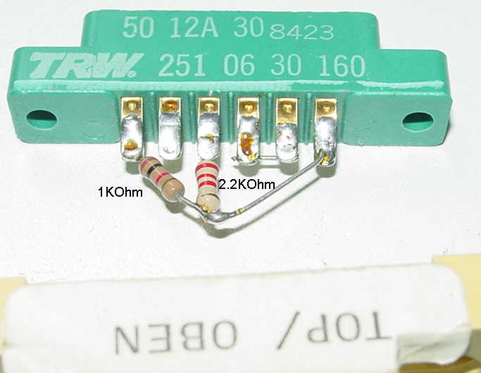

I have two two-prong power supply VIC-20's I'm working on. They both boot just fine. When I run the diagnostics on both of them, I get a BAD result for the cassette port test on each of the VIC's. Yet, newer VIC's (5-pin power connector) pass the diagnostics without any issues. No, I haven't actually connected a datasette up to them yet. I just find it odd that these older VIC's can't pass the diagnostics. I'm starting to question the cassette diagnostic harness.
The diagram for the harness from Ray Carlsen shows two 27r (2.2KOhm) resistors are needed, while the diagram from Zimmers shows one 1KOhm and a 2.2KOhm resistor. And the harness I'm using has a 1.2KOhm (4 bands - BROWN, RED, RED, GOLD) resistor, and a 11kKOhm (5 bands - BROWN, BROWN, BLACK, RED, RED) resistor. Strange, at least to me.
Has anyone else seen this issue?
Thank you!
Joe

The reason for the two resistors is to provide a voltage divider that reduces the voltage of the CASSETTE MOTOR line to TTL/NMOS compatible levels. Some mainboard revisions actually deliver a (badly regulated) "+5 V" there, others put around +6 V there, which exceeds the allowed voltages on TTL/NMOS inputs. In the case at hand, an NMOS input on one of the VIAs pins.
First, you describe the resistor values on your tape harness as being clearly different from either the Carlsen or Zimmers variant. Both happen to reduce the 5 .. 6 V from the activated MOTOR line to voltages in the range of 2.5 .. 4.2 V, all of which are within allowed high levels. In all cases, the 0 V from a de-activated MOTOR line also leads to 0 V on the voltage divider for the VIA input pin, i.e. low level.
If the voltage divider in your tape harness has the 1K2 resistor at the bottom, the voltage of the activated MOTOR line will be reduced to 0.5 .. 0.6 V, which is still low level. While electrically harmless (so to speak), the voltage divider would not work as intended, as the VIA input pin then sees a low level all the time.
The other way round gives 4.5 .. 5.4 V for the VIA input pin and there, the upper range limit is barely acceptable and may lead to unexpected behaviour (latch-up or the like).

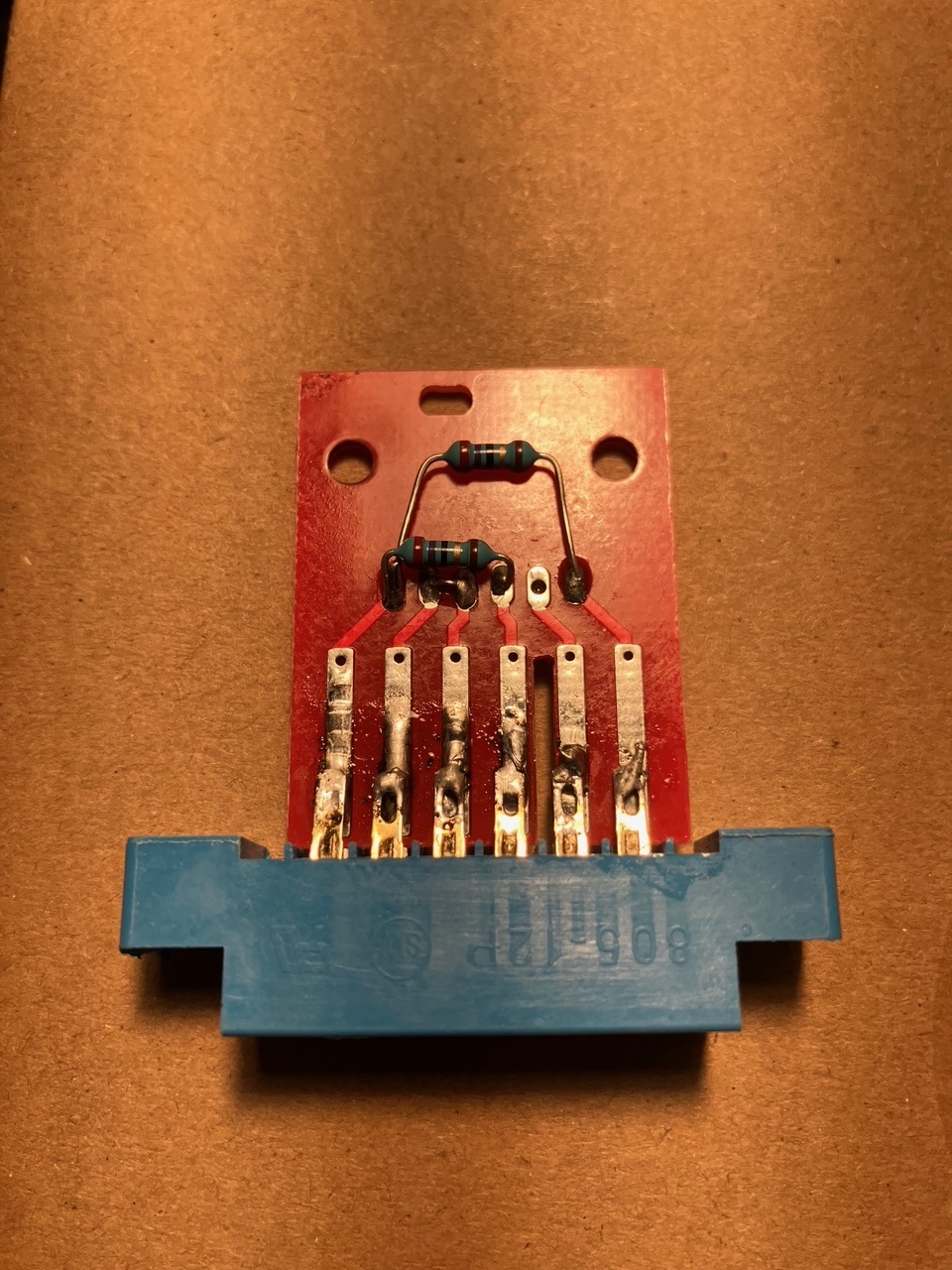

I found a solution to the problem with the cassette diagnostic harness. The harness that would give me false BAD test results has the following design:
The harness above works fine on CR VIC-20's, but not with the original (two prong power) design VIC-20's.
I found Ray Carlsen's hand drawn design for the cassette harness in a document that showed all of the harness devices. I cut the following cassette section out of the design:
Using Ray's design, I built a harness using parts I had in stock for projects, and some 27ohm resistors I received today via Amazon. Here's a photo of the completed harness (the solder I was trying to use is junk. I need to get some better solder):
With the new harness attached to the cassette port, the older version of the VIC-20 finally passes all of the diagnostic tests.

I spoke a little too soon. It turns out that some of the VIC-20's work with the cassette harness that does not have the 27ohm resistors, while others need the harness with the 27ohm resistors.
I still have one VIC-20 two prong system that can't pass the test regardless of which harness I use. The cassette works fine with it, but the system just fails the test. I'm going to start replacing the diode and transistors one at a time to see if the problem goes away. But first, maybe I should swap VIA chip positions to see if anything happens there. Both VIA's passed testing in my chip tester. But real world application can give different results.
Then I have a CR VIC-20 with the DIN power connector that fails the cassette test when using the harness that does not have the 27ohm resistors, but passes when using the harness that does have the 27ohm resistors.
So it's a mixed bag of which VIC-20's like which cassette harness. But at least it's nice to have both on hand.
