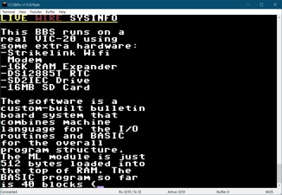

The Live Wire SysOp, RICK-T137, actually lives in your neighborhood, but here's the SysInfo:

Yes! The board runs on a real-live VIC-20 that was made in 1982. I've got some kind of clone of a VIC-1011A RS-232 board that connects it via a null modem cable to my Linux server. That server runs tcpser and acts like the "modem" to the BBS.
It's a really rudimentary system - pretty much just messages and bulletins. I have the code figured out to add Xmodem file transfers, but I haven't actually added to the program yet. The software is 90% BASIC and 10% ML - just used ML for the file and modem I/O routines.
If any of you are interested in the guts of it, I have the source code on Github - https://github.com/Rick-T137/vic-bbs
Anyway, thanks to everyone who has called it so far. I actually have more registered users on my VIC-BBS than I do on my C64 BBS (bbs.deepskies.com:6400).

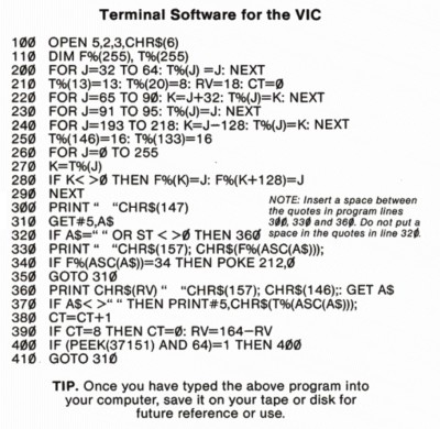

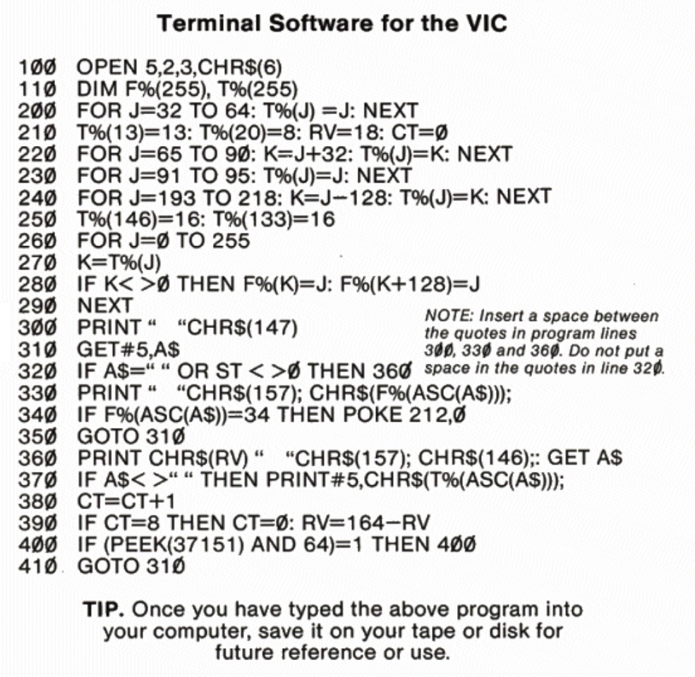

Hey OGM! I bet there's a bunch of us that started out with that VICMODEM BASIC terminal program! But it is designed to allow a Commodore to call out to an IBM BBS and do ASCII translation. For calling Commodore boards from my VIC in the early days, I just used a 4-line terminal program:
That's it! Mind you, this only works for terminal programs connected to a "modem" that supports Hayes commands.
10 OPEN 5,2,0,CHR$(6):REM 6=300 baud, 8=1200 baud
20 GET#5,A$:GETB$
30 PRINTA$;:PRINT#5,B$;
40 GOTO 20
