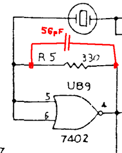

I recall that there is an extra capacitor required to get the crystal to start oscillating at the correct harmonic, so keep an eye open for that.

This is the cap that Jon is talking about. You must install it.
- PAL-CR.png (20.23 KiB) Viewed 3505 times
