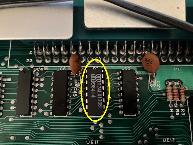

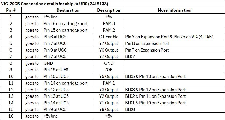

Promised information on the connections to/from chip UD9 (74LS133) on a VIC20CR. The schematics are not very helpful with the connections to and from this chip.
Joe

Thank you! But I already have. Ray's information is my primary "go to" for such things. That's where I got the list of chips that could be involved in the "Black Screen" (actually blank screen) issue.
I received the 74LS133 chips yesterday during a family gathering, so installing one had to wait until today. I haven't tested things yet, but I don't expect the issue to be resolved so easily. Especially when the chip appeared to have shorted out from water incursion.
Joe

I spoke too soon! The VIC-20CR booted immediately! Replacing the 74LS133 at UD9 did fix it!

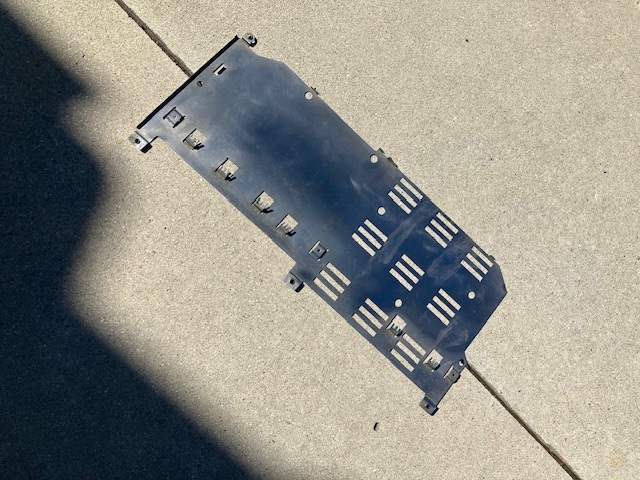

But here's an update on the case, shield, and the cardboard shield. I painted the cardboard shield black since the gray that I have is Rustoleum brand which has metal flakes in it. It's still ugly because of the wrinkles caused by the water damage. I'm also in the process of trying to make a new one from a piece of cardboard that was the backing to a drawing paper tablet.
As you can see, the case came out nice, and the shield is nice and clean as well.

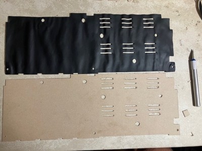

I made my first cardboard insulator by using the cardboard backing of a drawing tablet. I'm no artist by any means, but I think it came out good enough for a first try. Cutting the vent slits took a long time. About two hours overall for cutting it out slowly, and being slowed down by a blade that was getting more dull as I went along.
The black one is the original water damaged one that shrank down due to the water. Luckily, I used a good one from my other VIC-20CR as a template. So the new one is the size it should be.
Just waiting for parts to arrive so that I can repair the cassette/datasette power issue next.

Wow, Joe: that looks spot on! -OGM

That’s impressive especially for hand cut. I would have tried to get it cut on my Cricut machine. But then again I am stupid dangerous with a knife.
