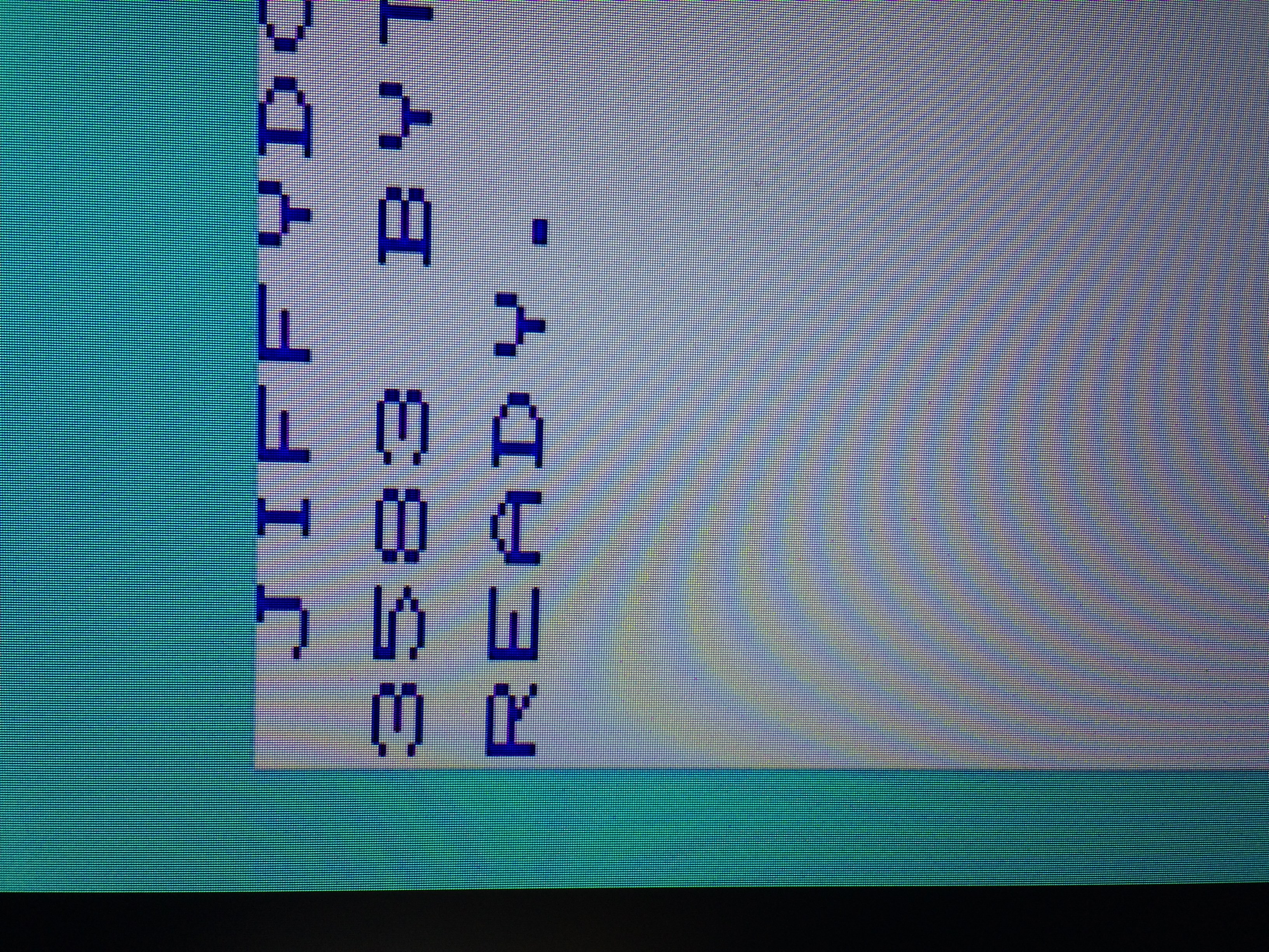

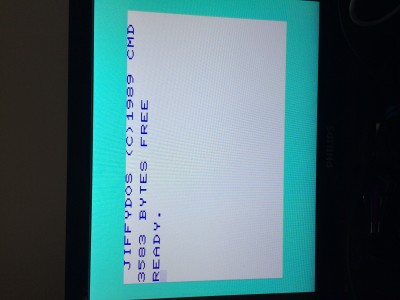

Post by repetto74 »
Received the kit from Mike and set this up in a second. Here is the result. Awesome! :D
Never saw a so crisp Vic-20 prompt in my entire life :shock:
Thank you!
