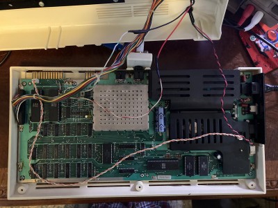

One of my VIC-20s (https://cbmvic.net/registry/503) gets hot. Touching it inside the cartridge port after a half hour is painful.
Along with this heat, the audio becomes strange. The mid channel plays unpredictable frequencies (for example, higher frequency values may sound lower in pitch than higher frequency values, and all frequencies are wrong in some way). When cool, the audio is as expected.
Are there any common root causes of heat? Would heatsinks anywhere be of any value? I've taken this VIC temporarily out of rotation, as I worry that the 6560 is in some danger, although video output does not seem to be affected.

Could you post a photo of the mainboard? I'd guess it's an early 2-prong machine with a single heatsink (the later 2-prongs got a heatsink separated from the expansion port, as people got burns when they handled cartridges ... :shock:).

Mike wrote: Thu Apr 21, 2022 1:10 am Could you post a photo of the mainboard? I'd guess it's an early 2-prong machine with a single heatsink (the later 2-prongs got a heatsink separated from the expansion port, as people got burns when they handled cartridges ... :shock:).
I don't think this one's particularly early. The chip date codes are consistently in the latter half of 1982.

Right now, I'm listening for one of the voices to diverge from the others. After 40 minutes, the expansion port heatsink is at 50C, and all the chips are between 30C ~ 33C. The VIC chip remains at 30C.

It's been an hour and I'm unable to reproduce the original problem, of VIC voices going out of tune. Maybe it's because I have the VIC case open to room-temperature air? I'll close it up for a while and see if anything changes. Temperatures are remaining really stable (under 35C) for every component that I can hit with a laser.
Re: Hot VIC
Yep... When I have the case closed up, the sound goes out of whack. When I re-open the case, the sound gradually goes back to normal after a couple minutes.
Re: Hot VIC
My bet is on either rectifier or voltage regulator. The VIC chip isn't particularly happy if it gets out-of-range supply voltage.
In the best case, the heat paste has dried up over the years, so you could try removing the sinks, removing old and re-applying new heat paste, and see if that improves things. Otherwise, you should replace both without much ado.
Re: Hot VIC
Mike wrote: Thu Apr 21, 2022 10:51 am My bet is on either rectifier or voltage regulator. The VIC chip isn't particularly happy if it gets out-of-range supply voltage.
Thanks! That sounds like a good plan. Wow, those voltage regulators aren't cheap!
