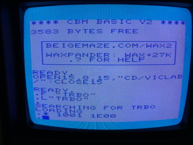

The cart supports SDIEC (obviously) but I didn't see a method to enter directories directly from the BASIC interpreter...loading one of the utilities into memory also fails for some reason; works fine without the cart. Any ideas? The Penultimate Cart has the utility built-in, do you think that would be a possibility?
Re: wAxpander with wAx2
Bradeep wrote: Sun Apr 03, 2022 8:34 am The cart supports SDIEC (obviously) but I didn't see a method to enter directories directly from the BASIC interpreter...loading one of the utilities into memory also fails for some reason; works fine without the cart. Any ideas? The Penultimate Cart has the utility built-in, do you think that would be a possibility?
You'll have to let me know if I'm on the right track here. I was today years old when I learned that you can even have subdirectories in a Commodore file system! But this seems to work for "entering" SD2IEC subdirectories on an SD card:
OPEN15,8,15,"CD/VICLAB/":CLOSE15
.F
Is that what you're asking about?

chysn wrote: Sun Apr 03, 2022 8:54 am You'll have to let me know if I'm on the right track here. I was today years old when I learned that you can even have subdirectories in a Commodore file system! But this seems to work for "entering" SD2IEC subdirectories on an SD card:
.F
Late late late reply, but yes, that was exactly it. Thanks, I wasn't sure how that worked, now I do.
