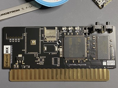

Mr Senior Cartridge has come a bit forward. It's main component is a 32bit MCU STM32F722 from ST and a 64Mbit DRAM from Windbond.
The MCU simply emulates the Flash and RAM in software. This gives every possibility to do some fancy stuff besides the obvious and standard features of a ram expansion.
To time this well I also have one of these cheap programmable logic components as in junior. Here we use extensive use of the delay lines to skew the interrupt to the MCU just at the right time so once the interrupt service routine has done all its housekeeping the adress and data is available. Every cycle counts.
Having a MCU also creates the possibility to have a SD card for all programs as well as BLE and WiFi (the larger unpopulated module). There is also a back-up RTC.
Thomas Lövskog

Does the ARM automatically connect to the DRAM and handle refresh, or do you implement your own refresh scheme?
Jim
TLovskog
Posts: 194
Joined: Fri Mar 25, 2011 3:16 pm
Location: Kävlinge, Sweden
Re: My hardware project :: GCart 2011
Post by TLovskog »
Yes. All STM32 has a memory management unit / controller. All can handle Flash memory, Static RAN as well as QSPI SD cards. Some, as with the STM32F722, can also handle dynamic memories natively and automatically.
From the MCUs and the programs perspective these 8Mbyte of memory is one long linear mass of memory.
The SD card is in a similar way also mapped as ordinary memory. All the QSPI calls are handled in the background. Although with the limitation that the window into the SD card is maximum 256M.
/Lövskog
