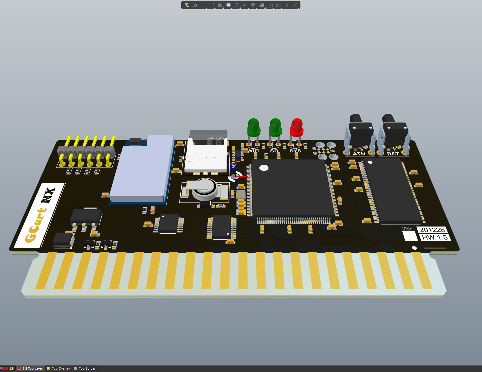

Anyway, I have had some really lazzy and relaxing days of and got some time last two days. So I actually couldn't really stay away so I just sent this for production. Yet another incarnation of my ideas.

Looks good, what has changed?

Post by TLovskog »
Mostly simplified the design, and also settled on an really old idea of simulating most of the RAM, ROM and IO subsystem in software. I tested that in 2012 with a dsPIC. but it wasn't really capable. I have then tried some different approaches with Cypress PSoC and FPGA.
I have since last year very good prices on STM32, so I have tested with STM32F429 and STM32F723.
I have also changed to another WiFi module from Dialog DA16600. That also includes BLE.

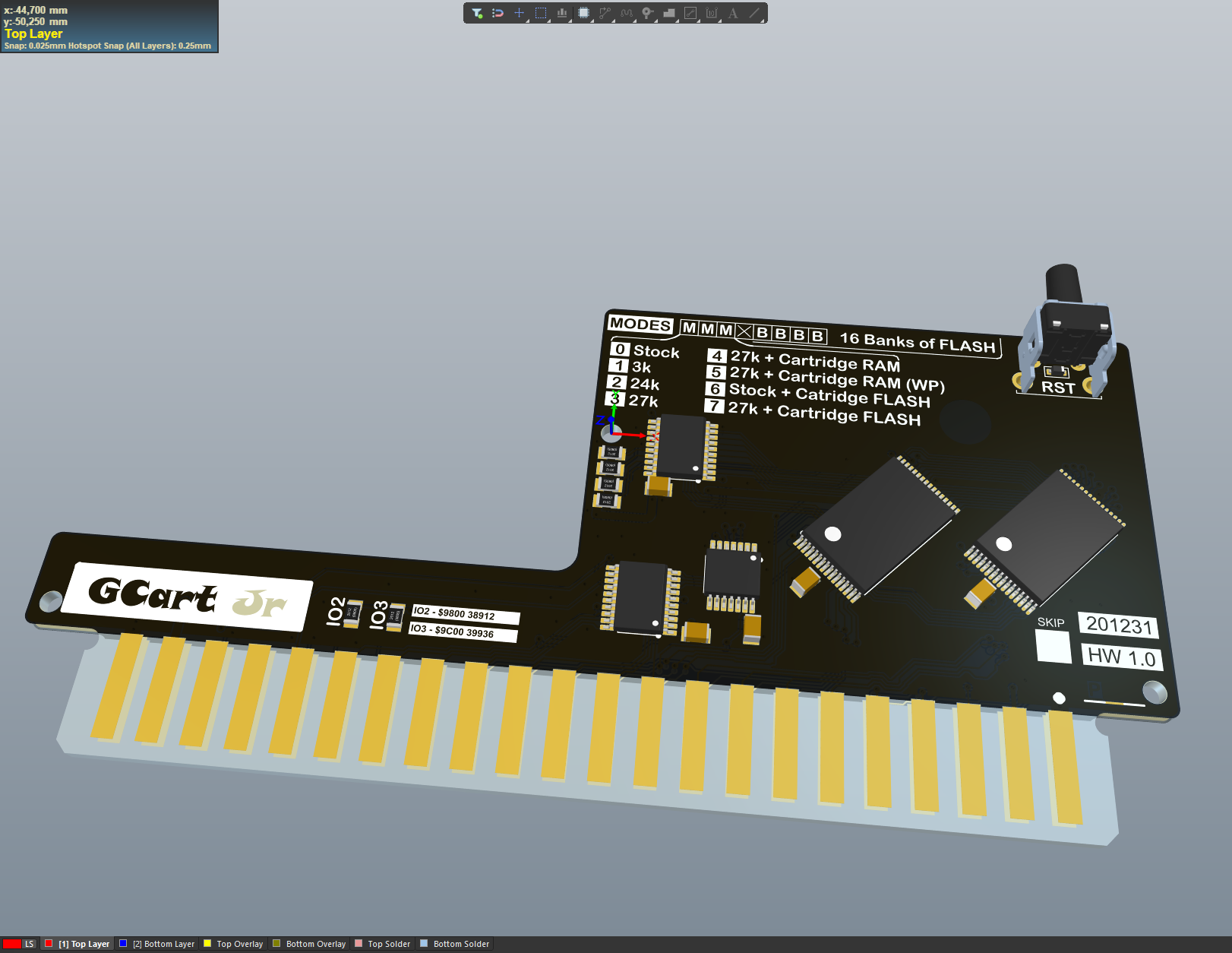

I also have this simple cartridge that is more for internal testing of a very small but dirt cheap programmable 5V tolerant circuit.
Still it has (intended to have) a simplified configurable RAM expansion on BLK1-3 and RAM1-3 with no banking. RAM on BLK 5 that can be write protected.
RAM at IO2/3.
There is also 1Mbit FLASH in 16 banks of 8k.
Although the BoM cost with components and PCB with hard gold is very low, I think the feature-set is a bit to limited compared to other cartridges out there, so this is more for internal use.

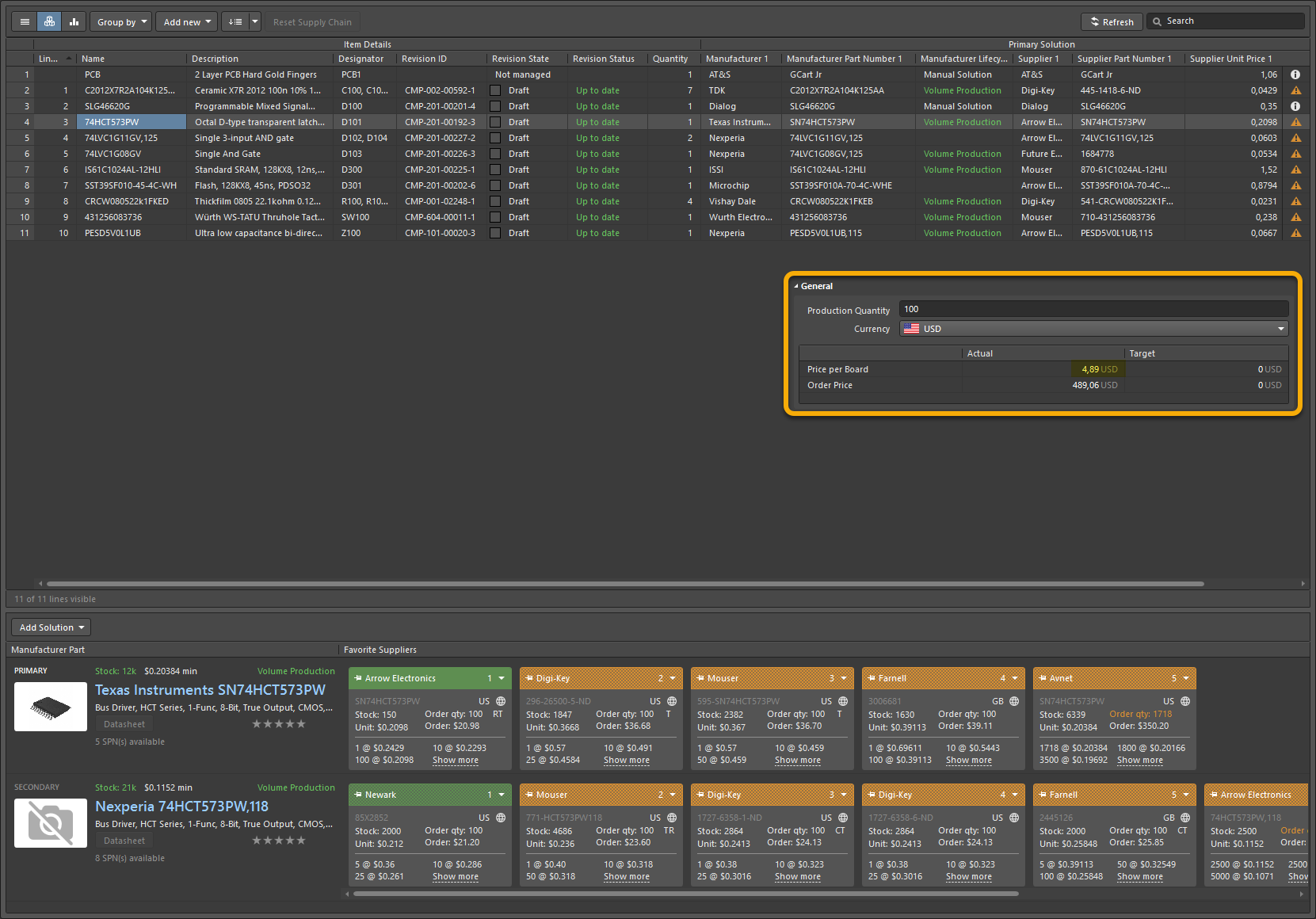

PCBs are on their way, and I have ordered all components for both boards.
I will start with the simple one since I need it for development of the code that goes into Dialog GreenPAK SLG46620 programmable logic. Array in quotes since it has VERY few LUT, but on the other hand costs nearly nothing, works with 5V and have just about enough for the glue logic I believe.
The BoM is quite favorable at under 5 USD including PCB, in volumes of 100.
