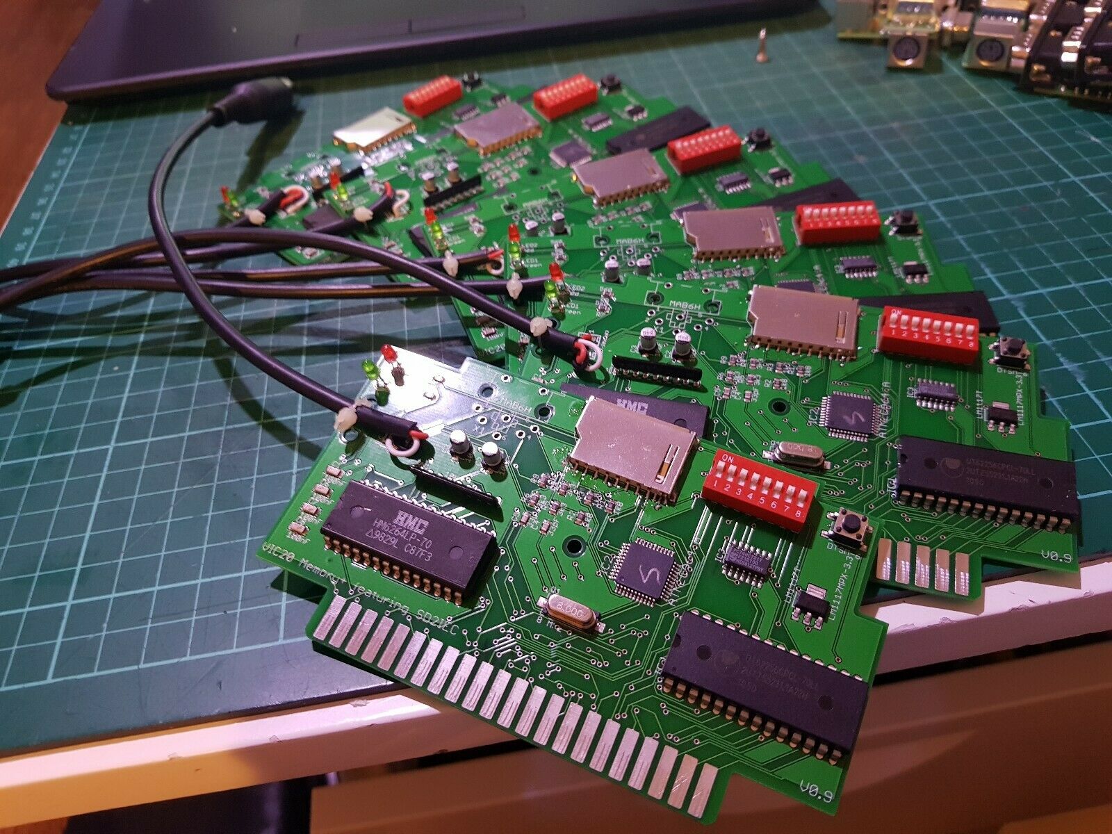

I like it because it's all in one and it looks like it's using the 3D design case file I modded too.

Asked for this, from the seller.
