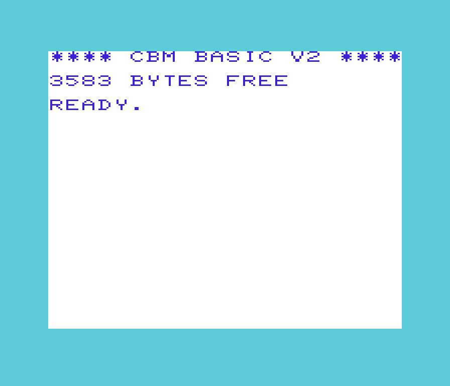

Since the VIC can not adresss memory outside the original 5K RAM you can just get a maximum usable resolution of 160x192 pixels which still keeps about the 4:3 ratio and works the same on PAL and NTSC. For higher resolutions you would either need to either sacrifice the lower RAM with the zeropage and stack, which makes handling those modes not so easy - or alternatively copy areas from and to the VIC-visible RAM on the fly as the raster-beam passes the screen. This would lead to a slower display in the end, but for a terminal-program this might be enough, moreso if the extra area over 160x192 is small enough.
A 192x192 image would use nearly the whole width of the NTSC-machine and may not be visible on every display-device. Also you might want to check the dimensions on-screen.

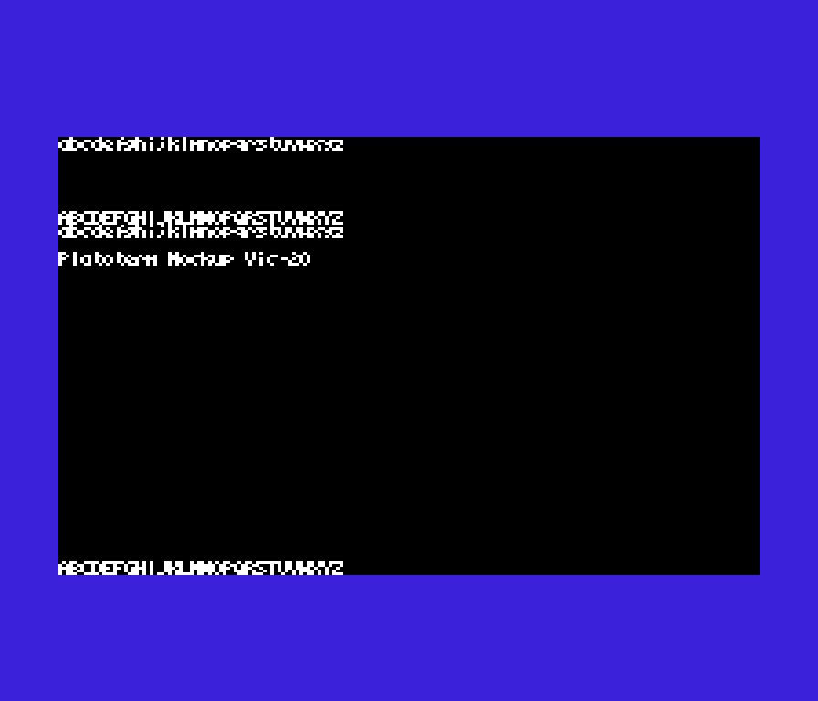

I would go for 192x160 display and 3x5 font on VIC 20. ALL CAPS and text-on-every-line get a little messy, but when the text is mostly a mix of uppercase and lowercase letters then it's still... somewhat readable. Fitting a few more lowercase letters like c, s, and z to a 2x4 box instead of 3x4 could help making it a even little more eye-friendly.
Here's a quick mockup and size comparison with VIC 20 standard screen. It's only 2 chars wider than standard, so it should be visible on NTSC machines too.
