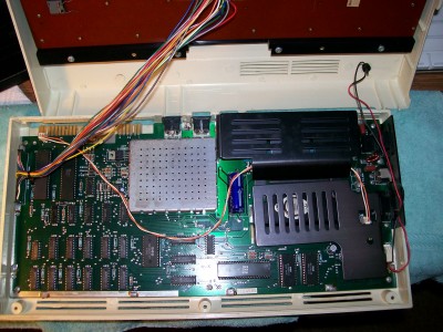

I looked for schematics and descriptions but was unable to pinpoint the bridge rectifier or voltage regulator. I've included a picture of the mainboard. I would appreciate any help identifying the correct components.

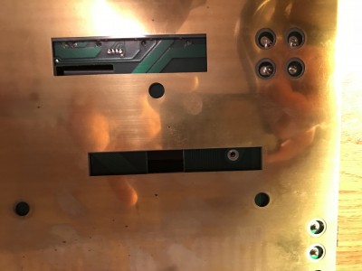

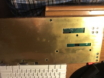

I also took the mainboard out of the case, to see if there were any damaged solder joints, but there is a gold shield attached to the board. Upon closer inspection it appears to be soldered to the board. I don't recall seeing anything like this in videos or documentation about VIC-20 restoration. I did see a few solder joins through cutouts in the shield, but none of them appear to be damaged.
Mainboard overview
Mainboard overview
Shielding on back of mainboard
Visible solder joins
