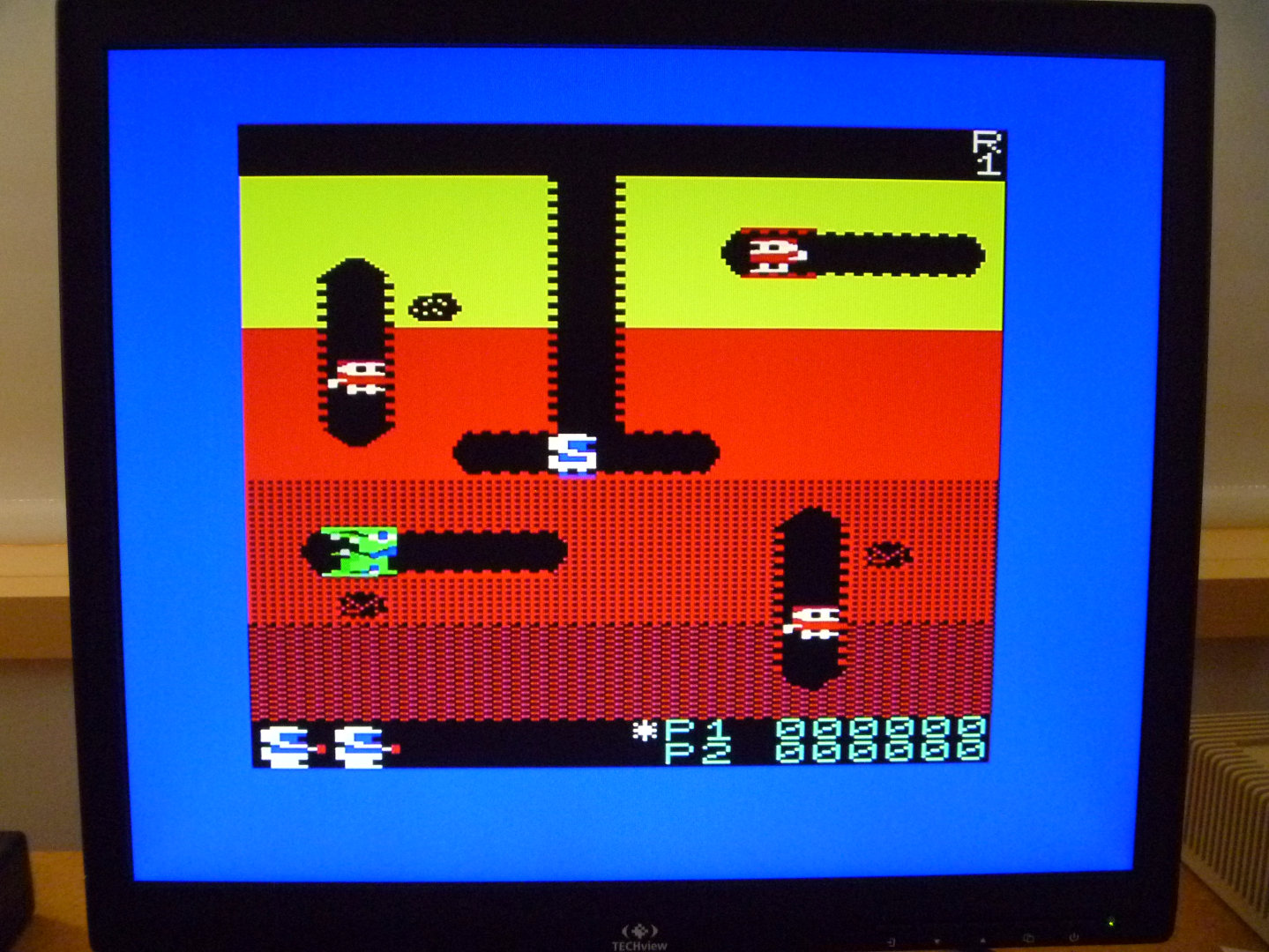

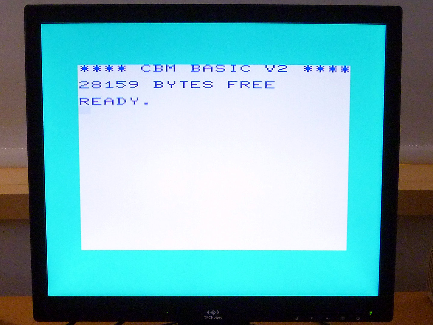

I use an LCD monitor intended for security applications. It has a 4:3 screen, so the display isn't distorted and it has an S-video input. My VIC is modified for S-video and the video levels carefully adjusted with an oscilloscope.
I think the results are very good, considering how we struggled with truly awful displays back in the day with RF modulators and dodgy old TV sets.
Here is the VIC boot screen: And here is how a game looks, in this case, Dig Dug: This is the monitor.
https://www.jaycar.com.au/17-led-survei ... r/p/QM3578
Unfortunately this monitor is no longer available. The replacement they suggest does still have S-video, but unfortunately it is 16:9. I have no idea how well it works with the VIC. Monitors intended for security applications seem to be a very good match for computers like the VIC or C-64. They are designed to work with TV cameras, some of which generate non interlaced video, similar to the VIC. I have found some LCD TVs will refuse to display non interlaced video, and in any case they tend to no longer have S-video inputs.
I will say that if you want to get as close as possible to RGB or VGA kind of quality, then S-video is a must.
