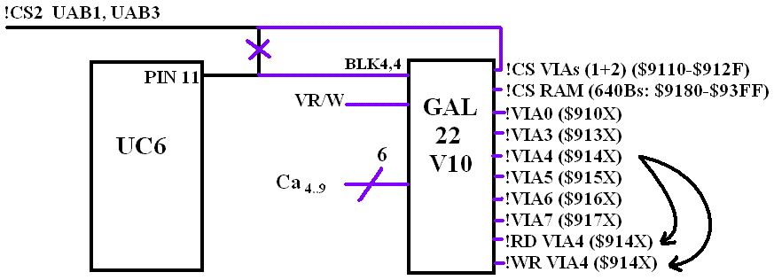

I got a little carried away decoding that area. It could've been done much simpler, but I was planning ahead, in case I might think of other items to put in that area. (I have, but that discussion would be more suited to the Hardware subforum.) Anyway, it seemed a waste to have the VIAs take up 768 locations, with gaps. I reduced the VIAs' occupancy to 64 locations (with gaps), and creating 6x32 addresses for more I/O, plus 512 bytes of RAM tucked away in I/O space.
Recently, I got someone who knows how to program a GAL to replace the two ICs and diode logic I used. Should make things much much neater -- and be a little more versatile -- when I get around to installing it.

Re: Writes to $9010-$901F
Mmmm....... an intelligent decoder for Richardc64 mod:
