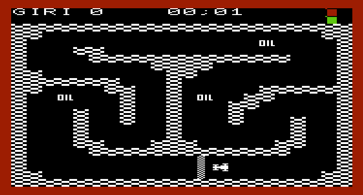

I take advantage of your kindness to ask for further help. In another program, called Grand Prix, some details are not displayed as they should. In the screenshot I attach, you can see that the colon and the traffic light (top right) appear redefined. It is likely that there are some typing errors on my part since the magazine scan is often not perfectly legible. In any case, I attach the original listing and the TXT file so that you can check. Many thanks in advance.

Found a few typos in line 250, and 360. That fixed the gameplay, but the broken chars are still there.
I noticed that the custom chars seem to be placed very close to the code/screen RAM. Stopping the program and typing on the screen modifies the start light chars already.

One typo is in 270, the POKE at the end is supposed to be for 7698. That fixes the ; and shows a start countdown.
Looking for the other char..

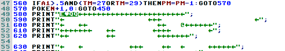

Edit: Holy shit! The author is using the character data overlapping with the screen RAM. The content of the playfield is used as source for the starting light. In that part of the screen there are no $00 value bytes however, only blanks ($20) or arrow left ($1f). The $20 is resulting in the little pixels at the top.
You could of course place a @ in line 600 (like in the screenshot), which would fix the display, but now you have a @ on the track.
Not sure if there's enough memory to place the char data somewhere else.
Edit #2: Munged some other place for the additional char. That is NOT the proper listing anymore, but modified line 170, 290 and 300 to use the init and use the new char. Added 172 as char definition for the light.

Endurion wrote: Edit #2: Munged some other place for the additional char. That is NOT the proper listing anymore, but modified line 170, 290 and 300 to use the init and use the new char. Added 172 as char definition for the light.
Great idea. I had the same idea, but you beat me to it. Since it's always better to avoid changing lines, I thought I'd add two more:
161 fori=7376to7383:reada:pokei,a:next
162 data0,126,255,255,255,255,255,126
So we have the traffic light exactly as the program author had planned.
