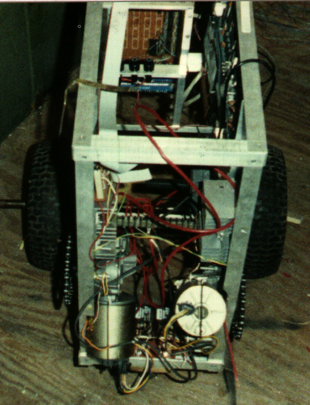

[M]ovable
[O]ff
[R]oad
[T]ransport
or M.O.R.T. for short
Not sure if it meets your criteria, but it was a labor of love. Always unfinished, and I still have it (disassembled, I need to re-assemble it). It ran on a 12V car battery and used windshield wiper motors for the driveline. I used the VIC-20 because it would run off DC (the 64 needed AC) and it was easier for me to interface, as Radio Shack solder the 22/44 .156 cards and I found a nice 22/44 card cage that I was able to modify to support the long cards Radio Shack sold.
Hand soldered breadboarded pulse width modulated (PWM) drive electronics using counters and a comparators connected to registers located in the memory map.
It did not do much or do it well, but I am proud of it.
Jim
[O]ff
[R]oad
[T]ransport
Jim
