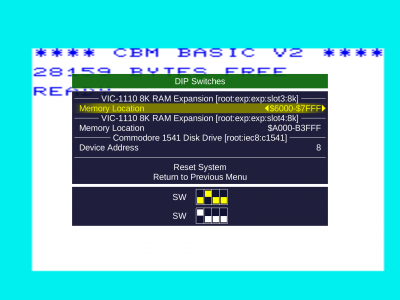

Re: Getting a fully expanded VIC-20 on MAME?
I should have read your question more closely in regards to wanting all RAM blocks assigned.
The internal UI allows for that, if you first assign the memory expanders into the slot expansion card first.
Then, go to dip switches menu option and alter them to occupy the address spaces and reset the machine (you can see it reports 28159 in the background): This will save your vic20 machine configuration as:
As long as you pass the memory expanders into those EXPANSION slots, VIC will detect and use them. If you do NOT pass them, no problem, the emulator does not care and VIC will startup with what IS assigned, i.e.,
You can decide if you want to pass a different -cfg_directory to point to different folders that may have completely different vic20.cfg machine profiles settings, including disk drives, printers, and any associated dip switch settings.

mame vic20 -exp exp -exp:exp:slot1 3k
mame vic20 -exp exp -exp:exp:slot1 8k
mame vic20 -exp exp -exp:exp:slot1 16k
mame vic20 -exp exp -exp:exp:slot1 3k -exp:exp:slot2 8k
mame vic20 -exp exp -exp:exp:slot1 3k -exp:exp:slot2 16k
mame vic20 -exp exp -exp:exp:slot1 3k -exp:exp:slot2 16k -exp:exp:slot3 8k
mame vic20 -exp exp -exp:exp:slot1 3k -exp:exp:slot2 16k -exp:exp:slot3 8k -exp:exp:slot4 8k
