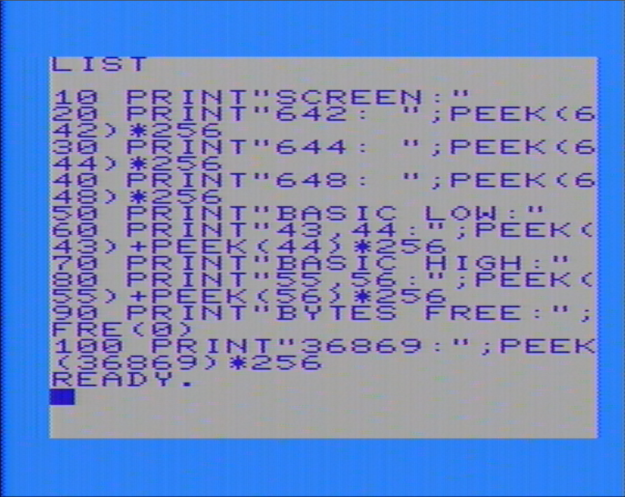

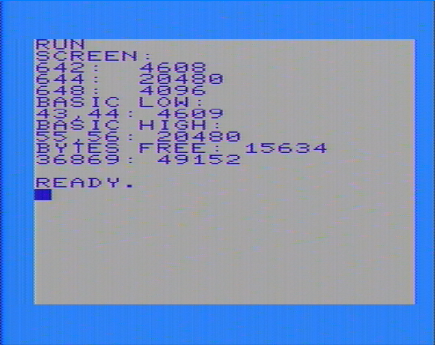

I'd like to be able to post a definitive memory map of this unique VIC, and I can think of no better place to ask than here! :D I've included what I've used so far to check, along with what it returns. Any suggestions for how best to approach this?
My intent here is preservation, so if you have questions about these machines, or things you want me to check, let me know.

CommodoreZ wrote:Any suggestions for how best to approach this?
36869 has a different mapping from how you interpret it (it's not the high byte of any address, but rather encodes the screen and character base address in its higher and lower nibble, respectively) and of course FRE(0) 'misses' the space already occupied by your test program.
Other than that, the output is pretty much in concordance with what I wrote: the screen is at $1000 and BASIC RAM spans $1201..$4FFF.

Mike wrote: Tue May 17, 2022 2:58 pm 36869 has a different mapping from how you interpret it (it's not the high byte of any address, but rather encodes the screen and character base address in its higher and lower nibble, respectively)
Then I will remove the 256 multiplier.
Mike wrote: Tue May 17, 2022 2:58 pm FRE(0) 'misses' the space already occupied by your test program.
A friend recommended that I toss it in, so I obliged.

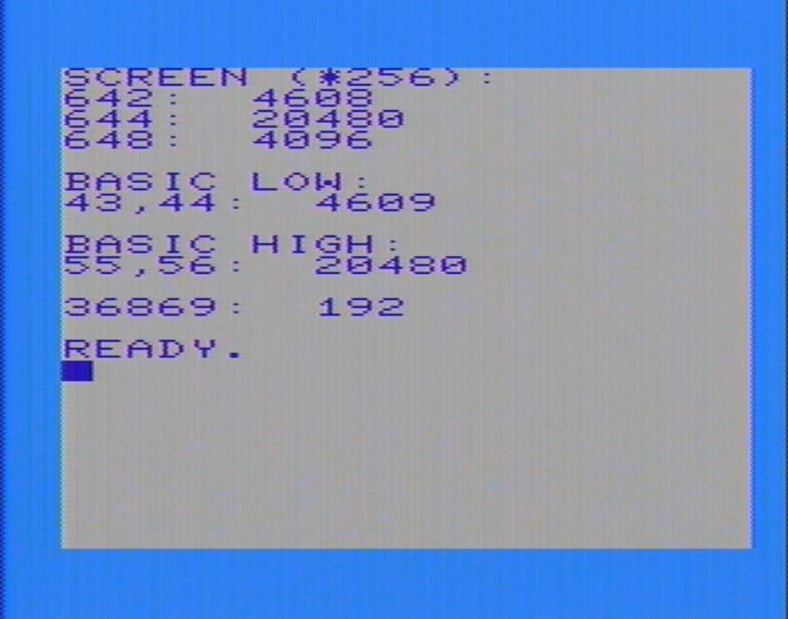

Alright, here's the updated version that I plan to put on the webpage about these boards.
