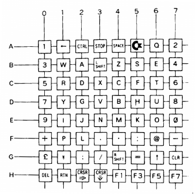

And here we go, I found this pretty badly shaped keyboard matrix in an archived copy of the VIC Technical Manual. I hope it can be of use, even if it's not so readable (click to enlarge).

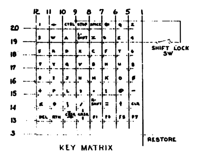

Re: Symbolic keyboard map for XVIC - Italian
Here's a better one from "VIC Revealed"
I still can't make head or tail about it
How does this scheme translate to a VICE keymap file?
It's particularly the third code (the shiftflag) that's eluding me.
Success! I've got it figured out.
The first thing to understand is that the shift codes are cumulative.
The second thing is that shiftcode "40" means "the key can be shifted" (8) + "another definition for the same key will follow" (32).
With this in mind, I've been able to map the "3" key correctly on an Italian keyboard (unshifted = "3"; shifted = "£").
4 1 0 40
4 6 0 0
42 1 3 2
54 6 4 2
Note that the first number is the sequential number the key appears on the Italian 105 PC keyboard, and that the numbering starts from 1, not from 0, so "3" is the fourth key on the physical keyboard.
The second number is the row in the VIC-20 matrix you posted; the third number is the column.
Note also that the shift code for the "£" is 0 (not "1" as I originally thought) because the shift code means "do you want the VIC-20 key shifted or not?". So if I put "1" there I get the PETSCII character you get on a real VIC when you hit the "£" key with SHIFT.
Finally, note that I had to define keys 42 (left shift) and 54 (right shift) for this to work.
With all this in mind, I'll eventually be able to post the IT sym key file for XVIC, and now you know how to do the trick for any language.
Cheers!
