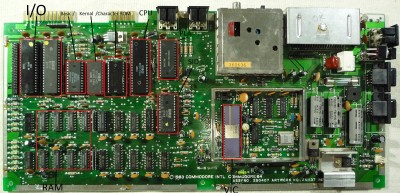

These are not my motherboards I took the pictures from online. They are the same type though.
-Floopy

srowe's link gives the answer: NTSC machines have a 14.31818 MHz crystal oscillator, which gets divided by 14 to produce the 1.022727 MHz clock while on PAL machines it's a 17.734475 MHz crystal divided by 16 to give a 1.108404 MHz clock. These odd frequencies are required for the colour burst signals of the respective analogue colour systems.
The crystal is the silver package visible near the purple VIC chip in your photo.

#1: The VIC-20's main clock is the crystal attached to the 6560/6561 VIC-I IC. The NTSC crystal is 14.31818MHz while the PAL crystal is 17.7344MHz. This clock is divided by 14 on the 6560 while it is divided by 16 by the 6561 before being fed to the 6502. The 555 is used to generate the reset pulse at the powering up of the computer, the C64 uses the 556 (a double 555) to also make sure the restore key is pleasant to use.
#2: For NTSC computers, yes. For PAL computers, no. The PAL C64 uses a 17.7344MHz crystal but the 6569 divides this clock by 18 before sending it to the 6510 making the PAL VIC-20 the fastest and the PAL C64 the slowest. Also, on the C64, CPU cycles are stolen by the video chip during screen refresh, more exactly 1000 cycles per refresh or 60'000 cycles per second on the NTSC C64 and 50'000 cycles per second on the PAL C64. This is why the screen goes blank on a C64 when loading/saving to/from the datasette.
