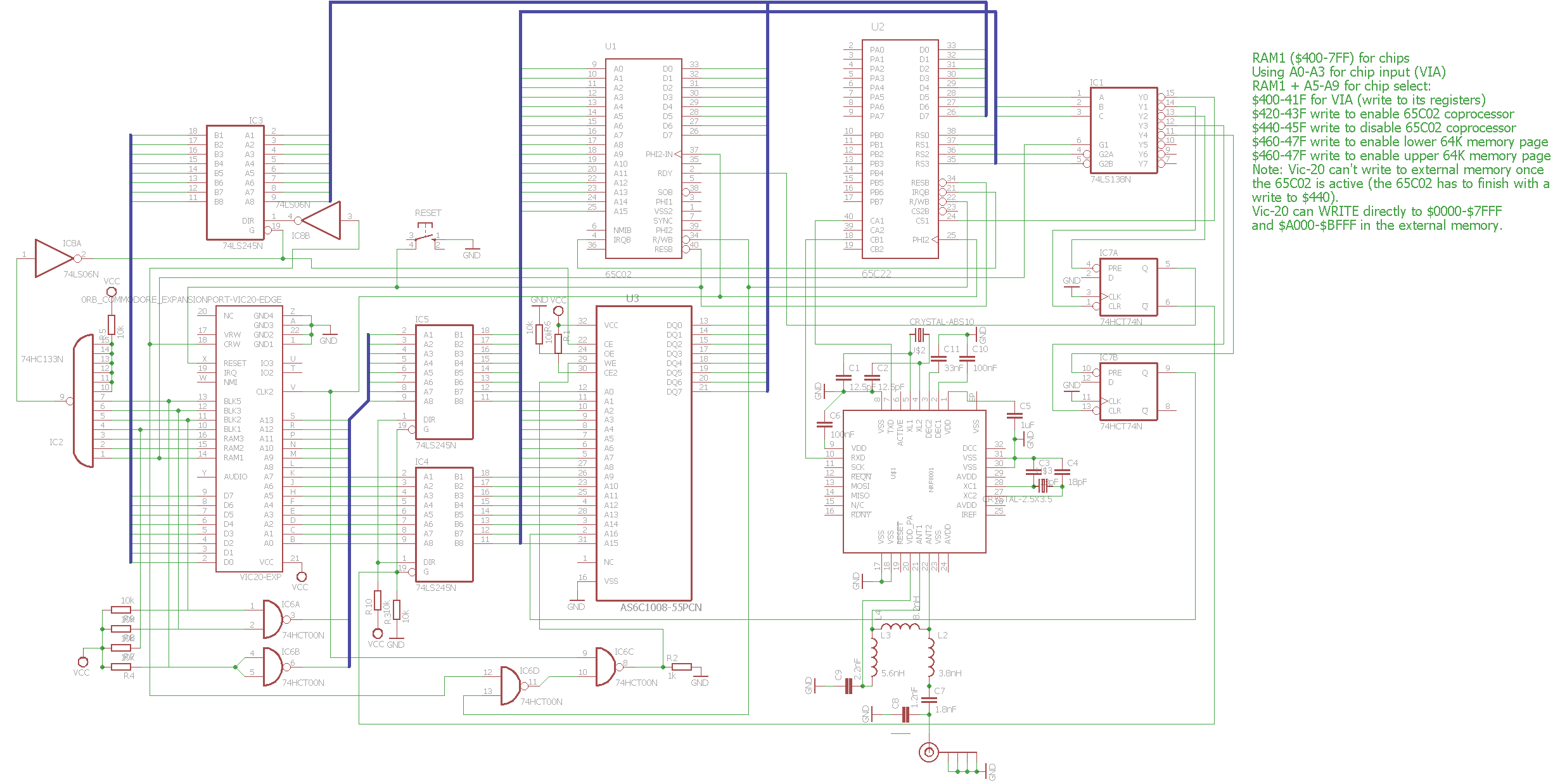

I have tried to put together my first layout and I must stay I'm quite green on this, even after years experience with making semiconductors and doing alot of programming. PCB layout just haven't gotten my attention.
Well, I tried to make a 65C02 coprocessor and a scheme to plug it into the Vic-20 expansion port. The basic idea is to share some memory and I added some flip-flop to actually set the "RDY" flag on the 65C02 so that it doesn't run until the 6502 of the Vic-20 tells it to. I also added a 65C22 and I have a feeble idea of paging a 128KB SRAM so that the Vic-20 gets some more memory to play with (e.g. 34K * 2).
Here is my current layout.. version 0.1 pre-alpha :oops: (and please ignore IC3 at the moment)
EDIT: version 0.2b pre-alpha... now also with Bluetooth LE and 20+ fixes.. Still need to fix the $400-> writes as the logic only works for the 6502.
EDIT2: version 0.4blue pre-alpha... parts of the circuit are up and running, so I can read/write to the memory chip from the Vic-20. Some bus stability problems on the external bus, but it can probably be fixed with some resistors.
Notes:
* The 65C02 should run faster than the 1MHz clock of the Vic-20. 10MHz should be possible.
* I will add a battery to keep the SRAM memory alive, even without power. It should enable some program at BLK5 to autoboot.

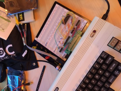

Well, debugging is kinda slow but it seems to get closer each day with the bus interface and memory mostly done:
Strange thing happends if the databus (D0-7) opens at wrong times. Most noteably the character colours gets randomized. I didn't think the 6561 could see the external memory, but it looks like it can somehow..
