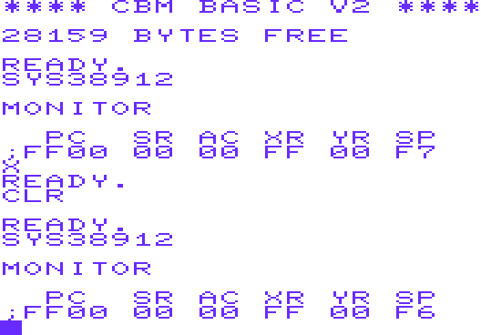

Posts: 5127
Re: "The Grave Cave" Eathenr0ss Software (c) 1982
tokra wrote:I confirmed this behavior of the stack-pointer being one less after STOP/RESTORE compared to RESET on my real machine as well.
The BASIC cold start (after power on or reset) initialises the stack pointer with LDX #$FB/TXS at $E381. Any action that at least partly involves the CLR routine at $C65E (BASIC warm start from STOP/RESTORE, program start, file I/O and BASIC runtime errors, after program load in direct mode, NEW) initialises the stack pointer with LDX #$FA/TXS at $C681. KERNAL and BASIC interpreter push some data on the stack before the already mentioned "$F3" or "$F2" values of the stack pointer are encountered.
In practice that means, the "$F3" value will only ever be visible right after reset; about any time later whenever BASIC deems it necessary to purge the stack, "$F2" will appear. That behaviour can also be observed with MINIMON (with the SP values of $F7 and $F6, respectively):
In any case, it is no emulation related thing. Real hardware shows indeed the same behaviour, also on C64 (see ROM addresses $E39D and $A681), C16/C116/+4 (checked with TEDMON) and C128 (also checked with TEDMON) ... quite probably on all 8-bit CBM BASIC versions.
