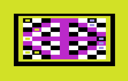

A graphic difficulty about Archon is that the board consists of at least three background colours. Maybe more; I remember it cycles, but not if it involves more than black, white and neutral. Preferrably add two distinct foreground colours, and you have a slight graphic issue to tackle. You could do it with blocky low resolution graphics (4x8) using border colour for one player and auxillary colour (high nybble of 36878) for the other player and use character colour for different background. It would look quite ugly, but could work. Here's a mock-up using solid blocks rather than detailed graphics. Each graphic could have a resolution of 8x16 double width pixels (occupying 2x2 squares).
As an alternative, perhaps one can use raster timing to constantly change background colour for each square, but it sounds very time consuming and sensitive to timing faults.
Perhaps it would be possible to use dithering to simulate shade changes on the squares that oscillate from dark to light....i.e. putting dots on every other pixel in the square in a checker-board (draughts) fashion.carlsson wrote:A graphic difficulty about Archon is that the board consists of at least three background colours. Maybe more; I remember it cycles, but not if it involves more than black, white and neutral. Preferrably add two distinct foreground colours, and you have a slight graphic issue to tackle.
Also, perhaps it would be possible to avoid using seperate colours for the game pieces by using one colour for the left side, and the same colour - but only drawing the outline of the the character forms with this colour - on the right side pieces.

Hello Carlsson.carlsson wrote: As an alternative, perhaps one can use raster timing to constantly change background colour for each square, but it sounds very time consuming and sensitive to timing faults.
The foreground begins at rasterline x.
At rasterline x-1 you can initialize 2 CIA timer.
Timer 1 runs one screen and goes to zero each rasterline x-1 and produces an interrupt.
Timer 2 runs 16 rasterlines (2 chars), which means:
interrupt @ x-1: set auxiliary color 1 (start of squares)
interrupt @ x-1 +(16*1) : set auxiliary color 2
interrupt @ x-1 +(16*8) : set auxiliary color n
interrupt @ x-1 +(16*9) : set auxiliary color 0 (no more squares, end of playfield, no more changes)
When Timer 1 goes to zero: initialize timer 2 again
This method wouldn't be very time-consuming, you need a counter for a table which contains the values for the auxiliary-colors you set in the raster-range.
Timing isn't critical, when the next line -1 is reached (IRQ) you can poll the raster-register for better timing.
Using two timers will slow down the speed of the computer of 1/10 because we have more interrupts.
The timer-values and line x depend on either PAL or NTSC-VIC.
