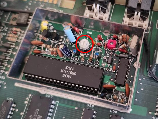

It occurred to me that you can maybe reduce the noise by adjusting the R10 potentiometer
Ideally you want this so that the output becomes more-or-less compliant (i.e. 1V between sync and white.)
indicated above by the circle. Turning it to the left increases the output voltage and could (in theory) reduce noise.Ideally you want this so that the output becomes more-or-less compliant (i.e. 1V between sync and white.)
