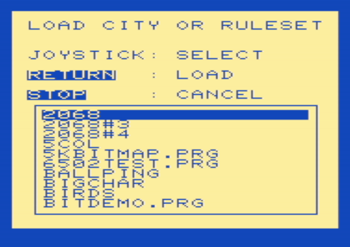

The lead on RC2 is that you can now save and load cities to and from tape, which is (quite literally) a game-changer. Other than simply saving your work, it opens up the possibility of a scenario editor, additional downloadable content, etc. It also allows me to test various scenarios for revenue and maintenance costs without having to start from the beginning each time. There will be some adjustments to these numbers before the final cassette version!

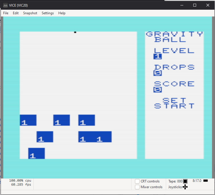

In rewriting Gravity Ball, I've noticed places where I can change the current character color to match the background color and then store data in screen memory where I don't need to display anything. This will shave a few bytes off the size.
I can store data in the blank lines between the scoreboard element and message window, and there will be 4-5 lines below the message window where nothing needs to be displayed. At 7 bytes per line, this will recover a fair amount of space. If I get desperate I can even store data before and after "Ball", "Level", "Drops" and "Score", recovering 8 more bytes. I gotta learn these tricks if I'm going to cut it programming the unexpanded Vic.

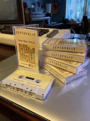

Getting ready for shipment!

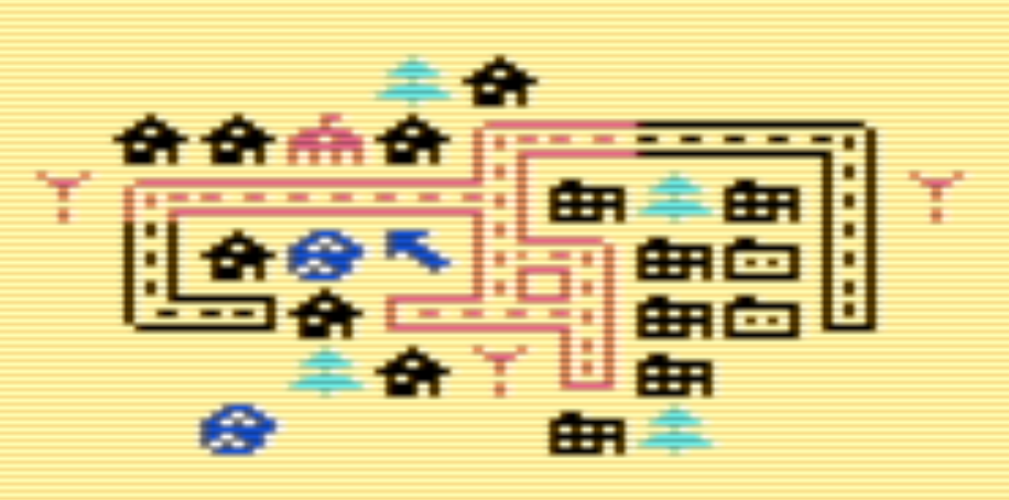

I added a "Road Trace" feature, which is a visualization of the effective area of structures. This will be in the final cassette release, which should be ready by the weekend.

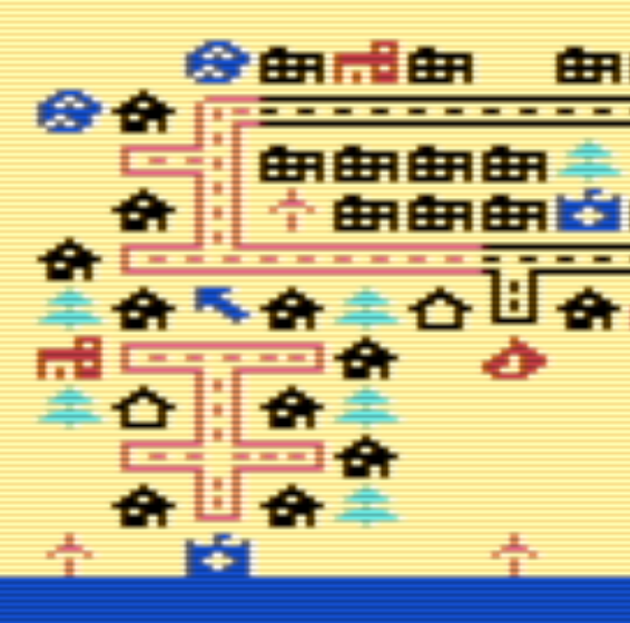

Here's a way to maximize revenue from services (Schools, Clinics, whatever your priority is) to Homes. By placing the structure in the center of a comb-type arrangement, the four-road range can go pretty far. Notice how the Homes are spread out, and how Parks are placed between orthogonal Homes, which turns the Park into a profit center.
This type of arrangement wouldn't work as well with Businesses which, unlike Homes, like to be right next to each other.
(in this case, the structure under the pointer is a School)

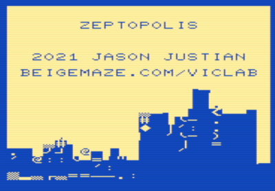

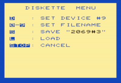

Within the next couple weeks, ZEPTOPOLIS will be available on cartridge. The gameplay will be identical, with the difference being that the cartridge version supports disk (I really wanted an excuse to use the word "diskette"). I also needed to add a splash page because I couldn't think of a way to seed a pseudorandom number without timing some kind of user action.
I resisted the temptation to do all kinds of things that I really shouldn't do.
