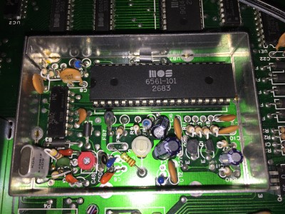

Photo here. You can see a couple of the ceramic capacitors don't look that great, but these components generally don't fail, I believe.[*]Any chance providing a detailed photo of the video circuitry around the VIC chip (the RF box)? Would make it more easy for me to direct you according to the schematics.[/list]
(mod: image link removed due to embedded e-mail address)

Hmm, C8 doesn't look too healthy...

Yep. It's a good idea to replace C8 without much ado. As first measure indeed before you proceed with the next step:wimoos wrote:Hmm, C8 doesn't look too healthy...
The unit display of the multimeter didn't switch to mV by any chance? That is easily missed, and 9.9 mV AC would be fine.boraxman wrote:For FB9, I get 4.96V on DC and 9.9V on AC. That doesn't seem right for the AC measurement, but I tried it a few times at both resolutions the multimeter supports.
2.21 V DC would be o.k. if a bit low. Again, the AC readout is possibly 3.9 mV AC. This is *not* in order and hints at a faulty Q2.[At the "E" pin of Q2] I get 2.21V DC and 3.9V AC using the same resolution as was used for FB9.
Q2 is somewhat difficult to source. You can't simply take another run-of-the-mill transistor as these usually have their pins arranged as C-B-E (collector-base-emitter), whereas the 2SC1959 in charge here has its pins arranged as B-C-E.
You might try here: https://www.ebay.com.au/sch/i.html?_nkw=2sc1959
If you go and replace Q2 - when you have removed the old one, operate your VIC-20 without Q2 and check the DC and AC voltage of the B pin (the other outer one, remember, B-C-E): DC should read 3.0 V +/- and AC again should read somewhat around 0.1 to 0.35 V.
Then, solder in the new Q2 as the assembly printing indicates and test.
We'll tackle the sound output once we get video working.

O.K. - then your multimeter isn't really suitable for that kind of measurement. It likely picked up the 9 VAC from nearby by capacitive coupling.boraxman wrote:With the multimeter set to the 200V range and a resolution of 100mV, I get a reading of 9.9. Set at the 750V range with a resolution of 1V, I get a reading of 9.
I believe the only difference between the two ranges is the resolution, the units remain as volts.
What you have measured was the ripple in the supply rail of the two transistors, as small as possible. With the "E" pin of Q2, the video output appears there, buffered by Q2. The bias (i.e., its DC value) is somewhat halfway between 0 and 5 V, and a normal video signal has an AC component with ~1 Vpp, which translates to 0.1 .. 0.35 Vrms (that's what your multimeter measures), depending on waveform.
A scope would be much preferred here, but I suppose you don't have one handy.
Yes, you should replace C8 in first place. After all, suspecting Q2 is only a good guess by me given the ambiguous readings.Thank you, I finally feel like progress is being made. It will take a couple of weeks for the transistor to arrive by mail (estimate is 12-24 of Nov). Due to COVID-19 the post has been quite slow, even for delivery within Australia. There is an electronics store near my house, but they don't seem to stock this part.
