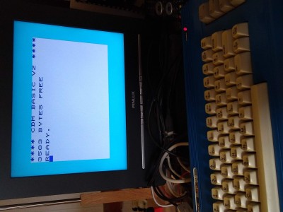

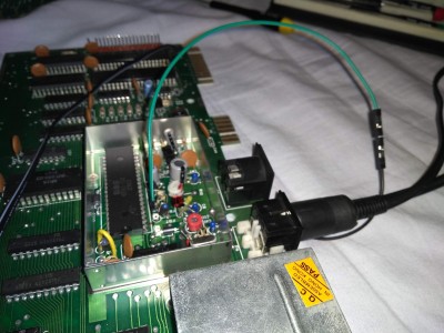

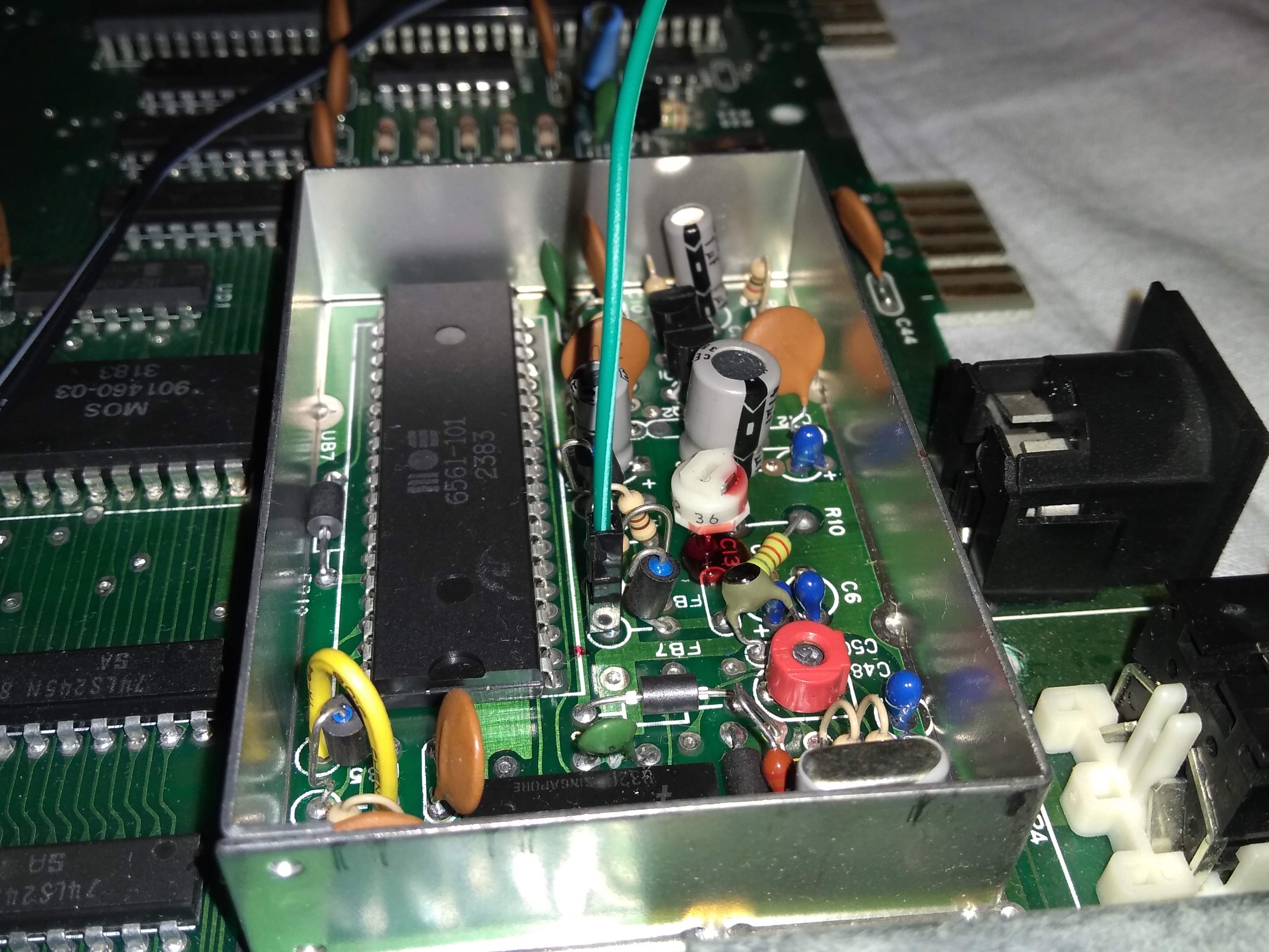

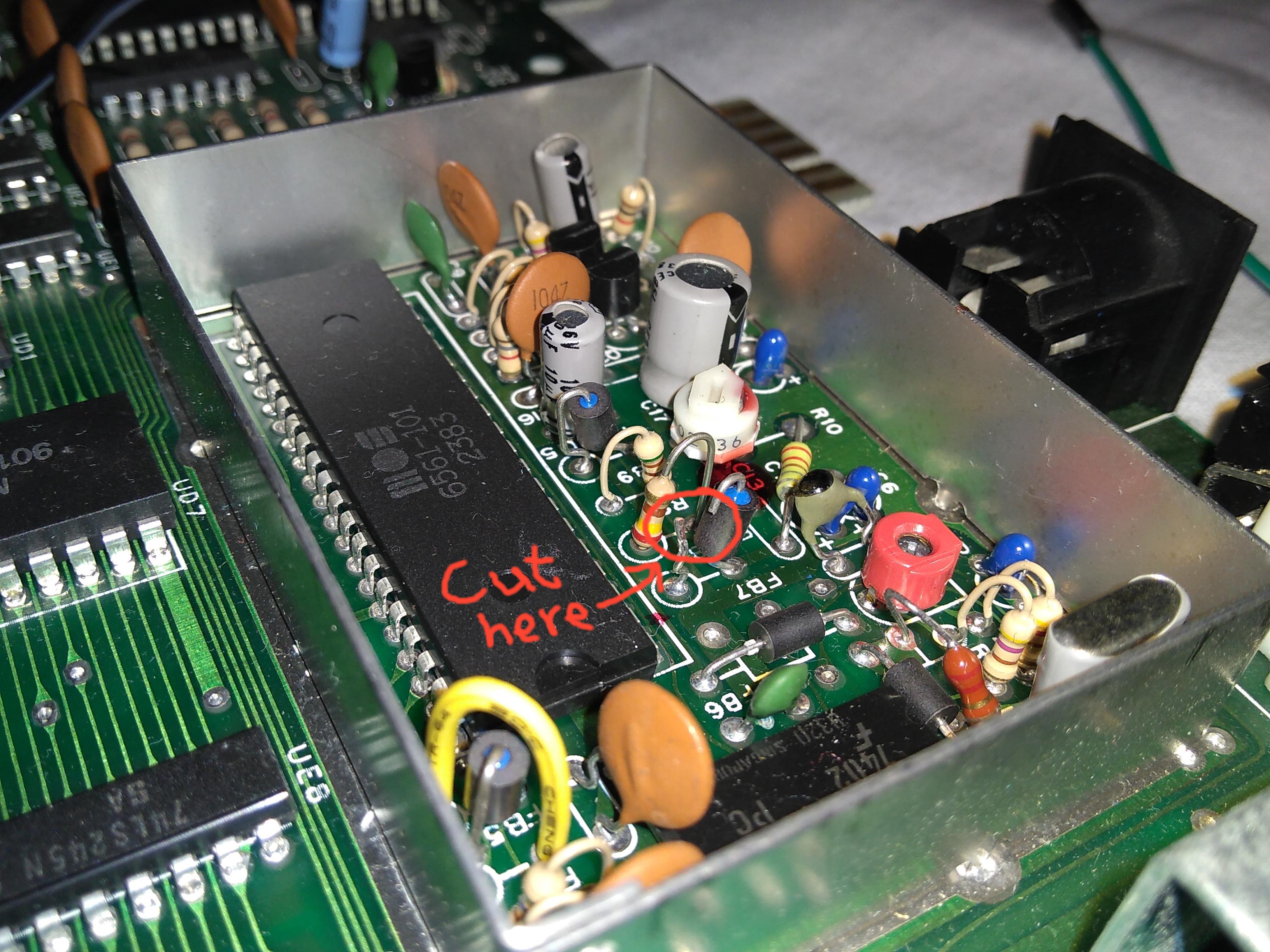

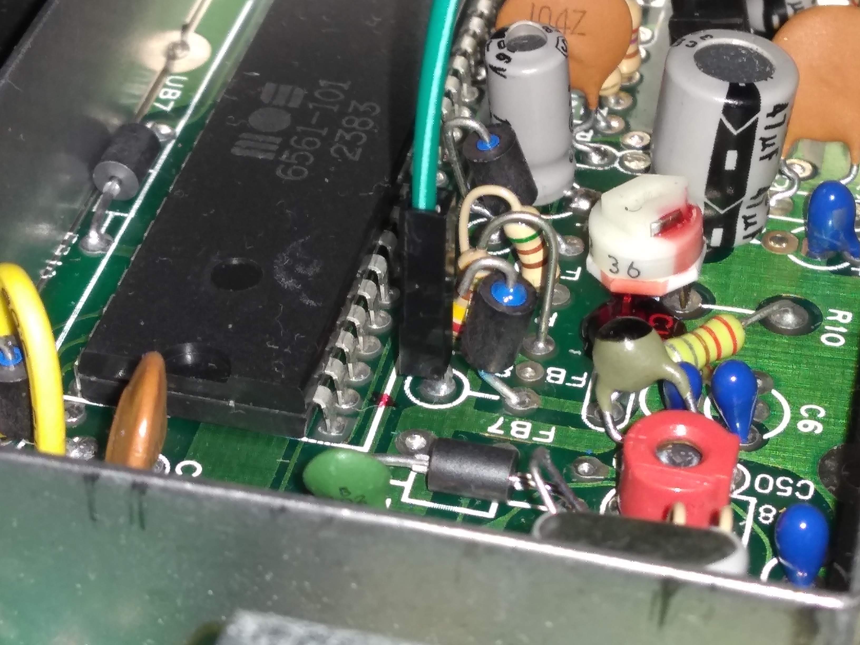

Simplest s-video mod ever for Vic-20CR. You only have to cut a lead (elevated from the board).See attached pictures.
You need a connection cable, as seen here: ( https://www.kjell.com/se/produkter/el-v ... Wis4PaQNNg ) It's a cable often used with arduino boards and similar.
Cut the lead on the vic-20 board as seen on my picture and stuck the cable on there, and there is your chroma signal. What's left in your video port is your luminance signal. Make a special cable that you can plug that extra cable into. (I already had one of those, from a plug-n-play s-video-mod that required the vic-chip to be socketed. )

Have you done much colour testing for games on your flatscreen? In particular, how do darker coloured sprites look with a black background? Are they clearly visable or are you struggling to see them?

English Invader wrote: Thu Jan 23, 2020 11:15 am Have you done much colour testing for games on your flatscreen? In particular, how do darker coloured sprites look with a black background? Are they clearly visable or are you struggling to see them?
Well, I haven't noticed anything strange. I have tried it on two different LCD TVs.

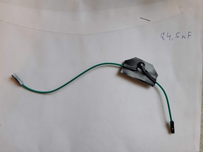

Because of Mike's comment, I made a small adjustment. See the attached pictures. This makes it electrically identical to the plug-n-play kit that was available some years ago. Thanks for the input.
