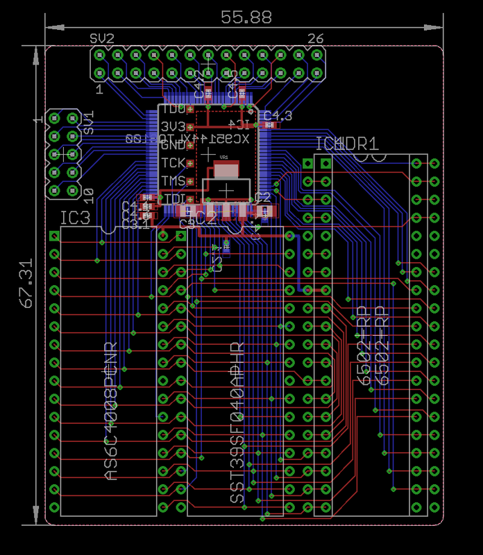

TO do some testing, I made up a small test board with 512kB RAM and 512kB FLASH ROM.
- Posts: 5037
Re: Soliciting VIC-20 Internal memory expansion ideas
I see both memory chips are Through-hole. I suggest you be careful this board can fit on all 3 types of VIC-20 mainboards and using surface mount can help you with that.
I also see your design uses a XC95xxXL CPLD along with a 3.3V regulator. Since a lot of careless people use 74HC (correct CMOS replacement is 74HCT or 74AHCT) ICs in VIC-20 cartridges and even sometimes repair VIC-20s with them, I suggest you raise the voltage to 3.6V to ensure full compatibility.
Then again, you specified this is just a test board... for the future, I suppose.
As you note, it's a test board, so I chose test ability over compactness. As a result, it will not fit in the first rev motherboard, due to the placement of the CPU relative to heat shields, I believe. (Well, it will fit for testing, with a riser, but not with the KB closed).
Jim
Jim
