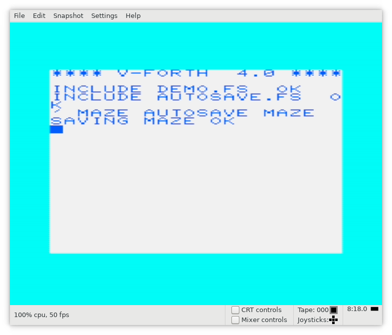

Re: V-FORTH - Forth-83 for the VIC
hello good day.
this not funktion in vforth 4.0
INCLUDE DEMO.FS
INCLUDE AUTOSAVE.FS
' MAZE AUTOSAVE MAZE.PRG
tanks
greeting
INCLUDE DEMO.FS
INCLUDE AUTOSAVE.FS
tanks
greeting

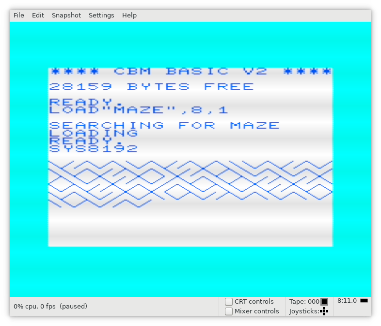

Hi good afternoon.
it works now.
I had made it from the vforth.rom.
it only works with the vforth.prg from the disk
sys8192 and control with the joy.
Thanks
Greetings
it works now.
Thanks
Greetings
