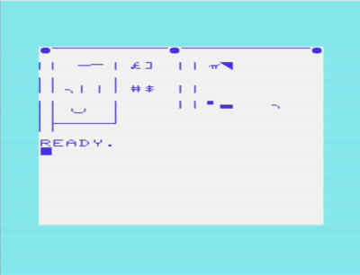

Thank you both for your replies. I'm using CBM PRG Studio v4's assembler and tools. I have generated a customer char set and screen in the designers and saved them off to binary files in the project folder.
Then I have the following code, cobbled together from watching YouTube and reading (I am a total newb at assembly).
; 10 SYS (5120)
*=$1001
        BYTE    $0E, $10, $0A, $00, $9E, $20, $28,  $35, $31, $32, $30, $29, $00, $00, $00
*=$1400
                jsr defchr
                jsr drawmap
                rts
defchr         ; redefine char memory
                lda #255
                sta $9005
                rts
drawmap
                lda SCRL
                sta $fb
                lda SCRH
                sta $fc
                lda MAPL
                sta $fd
                lda MAPH
                sta $fe
                ldx #2
main_lp         ldy #$00
loop1           lda ($fd),y
                sta ($fb),y
                iny
                bne loop1
                inc $fc
                inc $fe
                dex
                bne main_lp
                rts
MAPH            byte >SCRMAP
MAPL            byte <SCRMAP
SCRN=7680
SCRL            byte <SCRN
SCRH            byte >SCRN
SCRMAP
incbin         dksyscreen.bin
*=$1c00
incbin          dskychars.bin
I *think* I am loading the new character set because I see some of my custom chars - but the screen is corrupting so I guess I have garbage. So question 1 is, is there a better way to do this?
Then I *think* I am looping through the 506 bytes of the screen design loaded from the binary and outputting that to the screen using the technique you kindly described above. Question 2 then is why am I only getting some of the screen displayed rather than the whole thing. I have padded the binary file to 505 bytes and exported blank rows and trailing spaces in the export options.
Thanks again guys, any help gratefully received.

I think your main problem is that you are not loading the zero page pointers with the addresses you think you are. Try changing your code to:
Lda #<scrn
Sta $fb
Lda #>scrn
Sta $fc
Lda #<scrmap
Sta $fd
Lda #>scrmap
Sta $fe
The construct you trying does not work in CBM Prg.
Alternatively, you could use the loop Mike suggests, but I guess you are trying to learn how to use zero page addressing.
By the way, if you are using CBM Prg you can look at the Assembly Dump to check your code is assembling as you think it is.
Check back if you need any clarification.

Thanks Thegg - what's the difference with the code sample you gave me? Tried it and same results.
Setting the redefined char set aside and commenting that out, I get the result below. The top row looks as expected, it all goes wrong after that.
I'll look again at Mike's loop and try something like that.

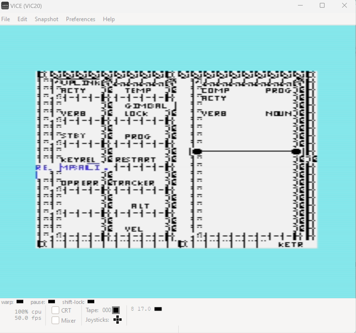

Hey all,
Thanks for the kind replies.
I've taken on board what was suggested and ended up with:

Still no joy...
Where am I going wrong now?

A couple of small points.
There is not enough room between the end of your Basic stub and the start of your code for the screen and colour data. So your code will be assembled on top of the last few bytes of your screen data.
You are including 65 character definitions (0-64) so the last definition is corrupted when you write to row 0 of the screen.
That said, as far as I can see, you should see the screen you designed providing your screen is using characters 0-63 in the character set you are loading.
If you can upload your complete project, I'll happily look at your character and screen definitions.
What version of CBM Prg Studio are you using? I think there were some issues with the screen editor in early versions. I'm using the newly released Version 4 which fixes some of the issues.
