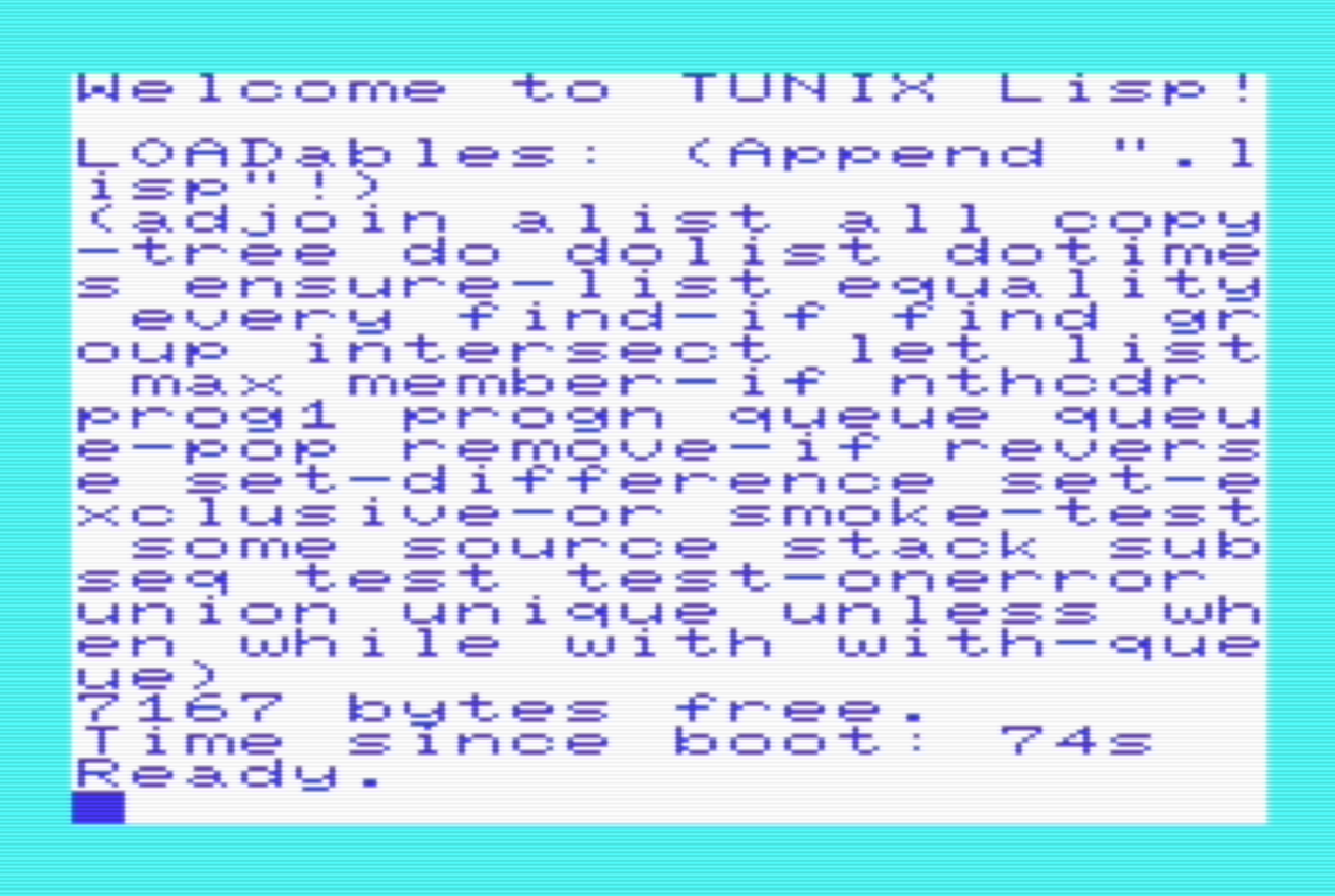

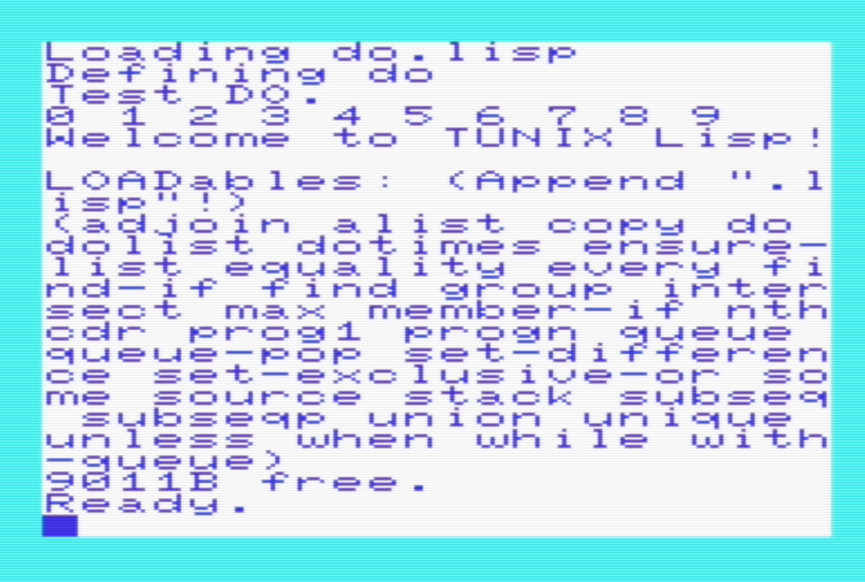

As usual on VIC-20 Denial exclusively. :p After all those nightly releases a pre-breakfast one:
* Loads only functions necessary for macro expansion plus macros LET, WITH and DO. (Only up to MACROEXPAND on the C16.)
* More functions can be loaded file by file. A list is printed after boot. Prerequisites of a function should load automatically.
* All files can be loaded with "(load all.lisp)". C16s will definitely not load them all. Takes ~6.6K of heap. If it doesn't read "Testing X..." X is not tested.
* "(debugger)" activates the debugger for the next user input too, so you can step through it right away without need for a BLOCK, or having to create and edit a file.
* Fixed expression highlighting in the debugger.
* The interpreter is a bit smaller.
Other notes:
* GC may take a couple of seconds, especially on the Plus/4 after it read in all of the environment. I figured that special effects are not necessary.
* Still, cc65 is doing the job with no trickery.
* UNDEF is a bitch. Don't use it. Spoils space travel.
tunix.cbm.2024-08-02.zip
(515.38 KiB) Downloaded 137 times

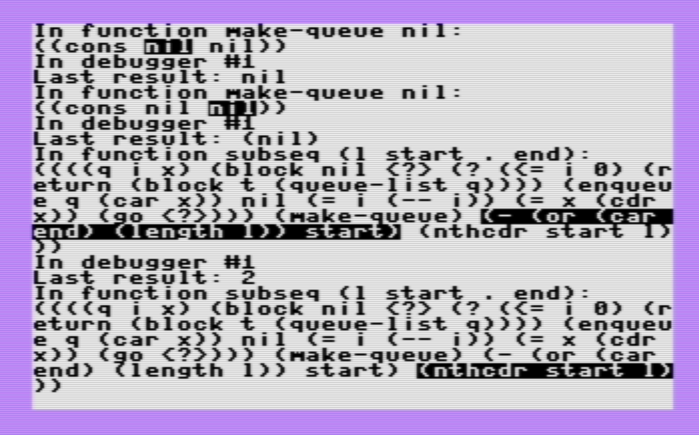

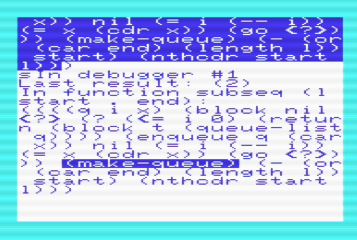

I was actually able to debug environment code with the debugger. :)
Something harmless to try out:
(load "subseq.lisp")
(debugger)
(subseq '(l i s p) 0 2)
(VIC-20)
(Plus/4)
Have fun!
tunix.cbm.2024-08-04.zip
(540.16 KiB) Downloaded 139 times

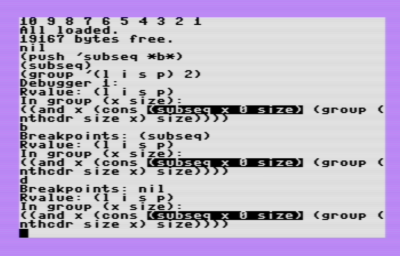

Breakpoints it is! I'll be on a bit of a vacation over the weekend and give the debugger some extra love to make it production-ready. Please check the manual for details. Heap compression might be taken to its limits too.
Have fun!
tunix.cbm.2024-08-08.zip
(509.41 KiB) Downloaded 151 times
