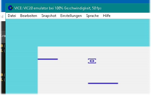

Hi good afternoon.
trse is great for the vic20.
a sprite 16 byte with vertical collison.
control with a / s / d / w
how do you get the horizontal collison down please?
greeting
program sprite;
var
i,b,x,y :byte;
        spr16L : array[] of byte = (
            %11111111,
            %10000001,
            %00111100,
            %00100100,
            %00100100,
            %00111100,
            %10000001,
            %11111111,
            %01100110,
            %10011001,
            %01100110,
            %10011001,
            %01100110,
            %10011001,
            %01100110,
            %10011001
        spr16R : array[] of byte = (
            %01100110,
            %10011001,
            %01100110,
            %10011001,
            %01100110,
            %10011001,
            %01100110,
            %10011001,
            %11111111,
            %10000001,
            %00111100,
            %00100100,
            %00100100,
            %00111100,
            %10000001,
            %11111111
       spr16L0 : array[8] of integer;
       spr16M0 : array[8] of integer;
       spr16R0 : array[8] of integer;
procedure spritetest();
begin
    if (vbmTestPixel( x+15, y+15 ) = 0) then
    begin
			y := y + 1;
			if (y>176) then y:=176;
    end;
    if (vbmTestPixel( x, y+15 ) = 0) then
    begin
			y := y + 1;
    end;
    if (vbmTestPixel( x+15, y-2 ) = 0) then
    begin
			y := y - 1;
			if (y=255) then y:=0;
    end;
    if (vbmTestPixel( x, y-2 ) = 0) then
    begin
			y := y - 1;
    end;
end;
procedure linien();
begin
for b:=0 to 20 do
	begin
     vbmDrawblot( b,30 );
  end;
  for b:=50 to 80 do
	begin
     vbmDrawblot( b,60 );
  end;
  for b:=120 to 150 do
	begin
     vbmDrawblot( b,80 );
  end;
  for b:=0 to 80 do
	begin
     vbmDrawblot( b,100 );
  end;
  for b:=100 to 159 do
	begin
  end;
  for b:=0 to 159 do
	begin
     vbmDrawblot( b,180 );
  end;
end;
begin
	vbmSetDisplayMode( 0 );
	vbmClear(0);
	vbmClearColor(blue);
 	vbmSpriteShiftR( spr16L, ^$a000, 1, 16, spr16L0 );
  vbmSpriteShiftL( spr16L, ^$a080, 1, 16, spr16M0 );
  vbmSpriteShiftR( spr16R, ^$a100, 1, 16, spr16R0 );
  vbmSpriteStitch( ^$a100, ^$a080, 128 );  // 8 x 16 = 128 ($80) bytes to stitch
  vbmSpriteShiftL( spr16R, ^$a100, 1, 16, spr16R0 );
  linien();
  x:=40;
  y:=70;
  while (true) offpage do
	begin
		i := getkey();
		case i of
			KEY_d:
			begin
				x:=x+1;
				if (x>144) then x:=144;
			end;
			KEY_a:
			begin
	      x:=x-1;
	      if (x=255) then x:=0;
			end;
			KEY_s:
			begin
				y:=y+1;
			end;
			KEY_w:
			begin
	     y:=y-1;
			end;
		end;
		vbmSetPosition1( x, y );
    vbmDrawSprite16e( spr16L0, spr16M0, spr16R0 );
    waitforraster( 0 );
    spritetest();
	end;
end.

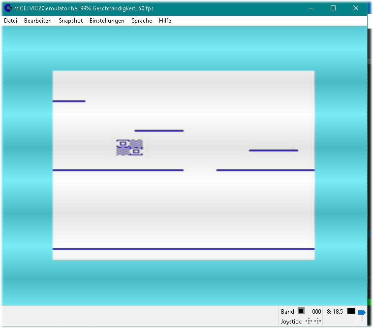

Hi good afternoon.
I have 2 sprites (8byte) which I can switch with the u / j buttons.
I can move the first sprite with: t / g / f / h
I can move the second sprite with w / s / a / d
both work.
how can you do that when switching
that the one sprite doesn't go away then?
Thank you.
Greeting

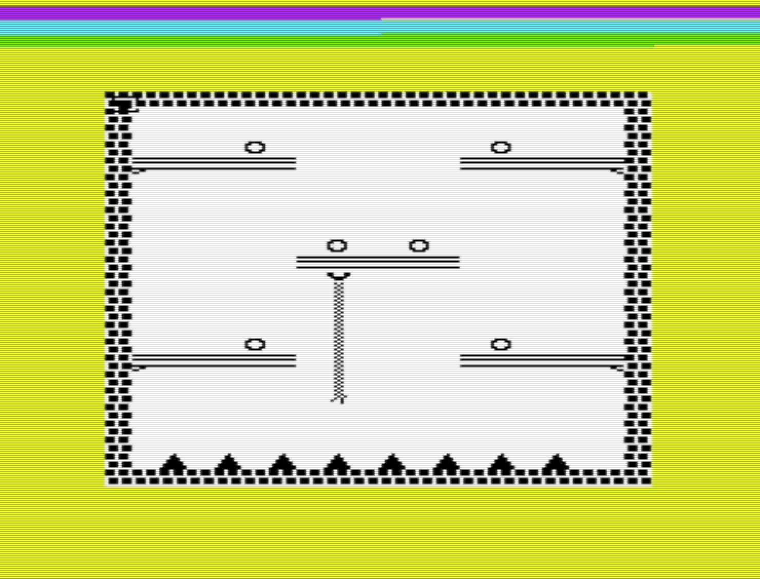

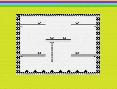

For next version I have added two commands to deal with saving and restoring parts of the bitmap to a buffer in memory, that way you can draw sprites as normal, or with a mask, and restore the background after.
Click to view animation
1) Save background (Cyan), 2) Draw sprite (Green) and 3) Restore background (Purple).

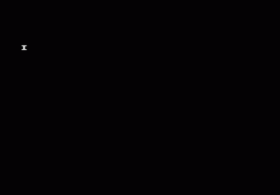

I've had a think about sprites. I have two helper methods for pre-sized sprites (8x8 or 16x16) and you can of course use sprite slices to make any size sprite you want, but it occurs to me that 8x16 is a useful sprite size too. So have added a helper command for that.
Click to play animation

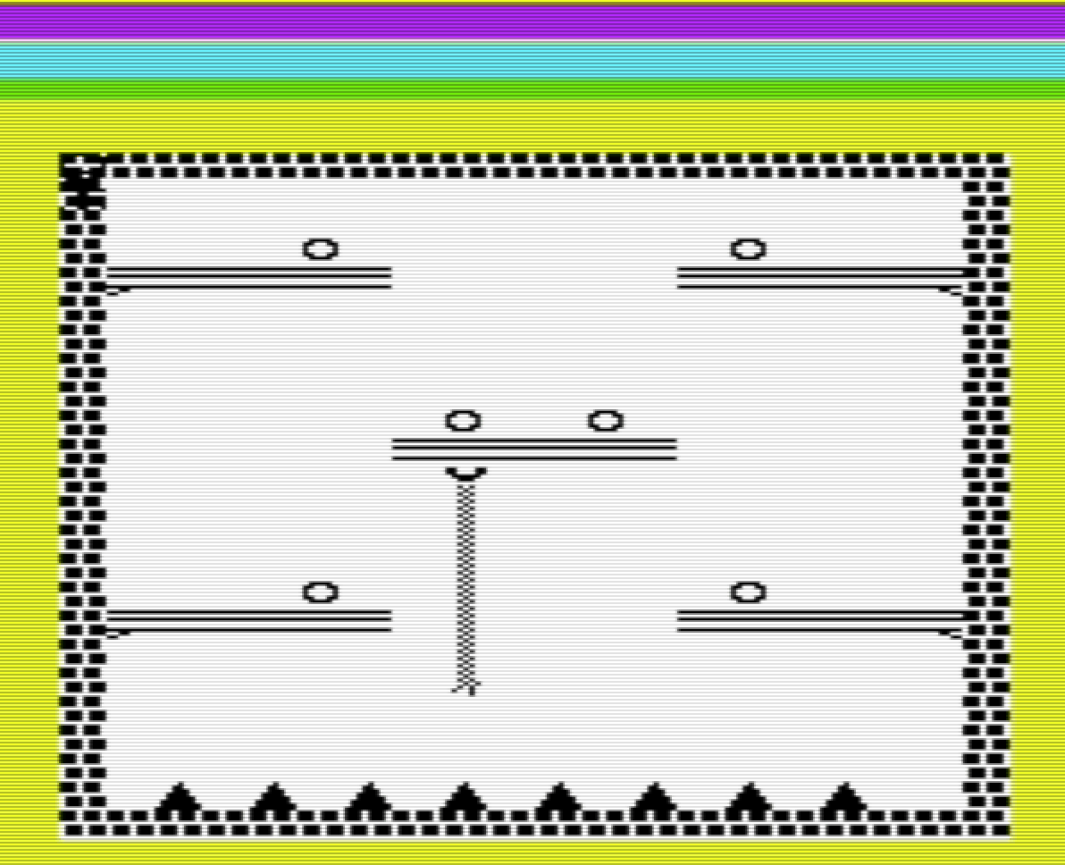

Next demo to show off Small Text that I added today. This was much simpler to implement than I thought it would be.
But more importantly, finally I can make a Llama Face...I mean Omega Race! :-D
