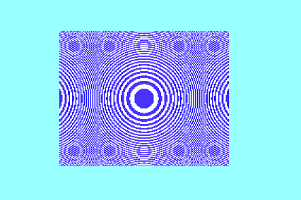

Hi,
I would like to introduce you to another graphic from the book "SPIELE MIT COMPUTER GRAFIK" from Norbert Treitz.
The normal speed, the counter counts up to 15382 . With the float point patch from Mike it runs a little bit faster. 15184
But, if you use SuperNumbers from the POST "Faster VIC20" the speed increases enormously to 9960.
SuperNumbers are of course the pound sign \ = £
Maybe the SuperNumbers could be included in MINIGRAFIK as an integral part?
And sorry again to send a lot of code here. I have some trouble to send the programs as a file, i dont know why?

Re: MINIGRAFIK lineart
For a fairer comparison of run times, in the standard version you should assign the most often used constants and variables to 'early' variables in very much the same way as you did with the version using SuperNumbers: (download)
0 @ON:@CLR
1 X=0:Y=0:E=1
2 A=79:B=80:C=95:D=96
3 F=150
5 TI$="000000"
10 FORX=0TO80:FORY=0TO96
15 R=X*X+Y*Y
20 IF(R/FANDE)THEN60
35 @E,A+X,C+Y
40 @E,B-X,C+Y
50 @E,B-X,D-Y
55 @E,A+X,D-Y
60 NEXT:NEXT
65 TE=TI
70 GETA$
75 IFA$=""THEN70
80 @RETURN
85 PRINT"ZEIT: "TE
This gives 11888 jiffies (original standard version: 15382 or 15184 jiffies, SuperNumbers: 9960 jiffies).
I sorted the variables and constants in line 1..3 roughly to how often they are used in the main loop in lines 10..60. The initialisation of the loop variable is not counted in - FOR stores away a pointer to the loop variable and NEXT already accesses it as fast as with SuperNumbers -, also note start and end values of a FOR loop are only read once and then stored, and thus also not counted in:
  • X,Y: 6 times (explicitly excluding their occurrence as FOR loop variables in line 10)
  • E: 5 times
  • A, B, C, D: 4 times each (explicity excluding their use as end values in the FOR loop)
  • F: only a single time, but 150 already is a 3 digit constant that internally gets parsed as (1*10+5)*10+0 ...
MrSterlingBS wrote:Maybe the SuperNumbers could be included in MINIGRAFIK as an integral part?
I have good reasons not to do this - and it is also not strictly necessary either: both tools already work together out-of-the-box.

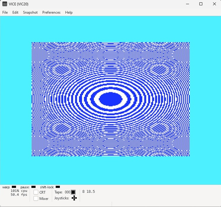

I rewrote the Fresnel program in floating point and interger assembler. Unfortunately I'm still missing the following conversion.
In my version i still calculate r=x*x + y*y without constants. For a correct mapping, the formula should be r=3/2*x*x + 2/3*y*y. I still don't have the right trick to do this. I can't quite get the result with the asl and lsr commands. Can anyone help here?
Program.zip
(1.16 KiB) Downloaded 244 times
The program is quite long for this application. This is because I use lookup tables for graphing and multiplication.

Post by MrSterlingBS »
For comparison, the BASIC version again with some small adjustments. The constants 3/2 and 2/3 were added and the constants A and B were swapped (not correct). (double calculation in the first two loop runs) In addition, the calculation x*x is only calculated once per loop run of y.
Solution = 11948 jiffies @ 160x192 pixels!
