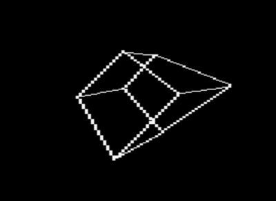

At the moment I'm… well… kinda throwing things away. But I managed to rotate a cube:
Re: Line drawing algorithm
pixel wrote:But I managed to rotate a cube: [...]
That cube must have been exposed to a rather strong gravity field in the vicinity of a black hole. :wink:
Vic 20 Guru
Posts: 1548
Location: Bielefeld, Germany
Mike wrote: Mon Nov 04, 2024 3:18 pm
That's the last working version. With the new thing I hope to be able to get the (8-bit) vertices of a rotated cube in about 600 cycles.

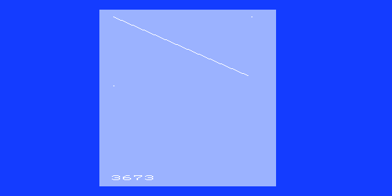

Hi,
After implementing the SBC/BCS technique, the line drawing routine became a little bit faster.
The results for a line are around 37 cycles per pixel. X1=10;Y1=10; X2=110;Y2=110
Screen sice 128 by 256 pixels.
The two dots are only to verify the start and end of the line.
Thanks a lot for the feedback.
Sven
Also, regardless how it is implemented, with
MrSterlingBS wrote:X1=10; Y1=10; X2=110; Y2=110
as start and end co-ordinates of the line, the routine should only do diagonal steps. However, in the screenshot I see interspersed horizontal steps that are not supposed to be there. So either the screenshot uses another set of co-ordinates, or there is a flaw with the routine. I take the given cycle count with a grain of salt.
Ah, yes, looks like a carry flag sneaking in with each new char column.

:shock:
Yes, there was an error in the routine.
I hope I can fix it today.
Sven
The routine is not finished yet and need further optimizations.But the principle works…
Here is the updated routine with no error. The screensize is now 168x192 pixels.
