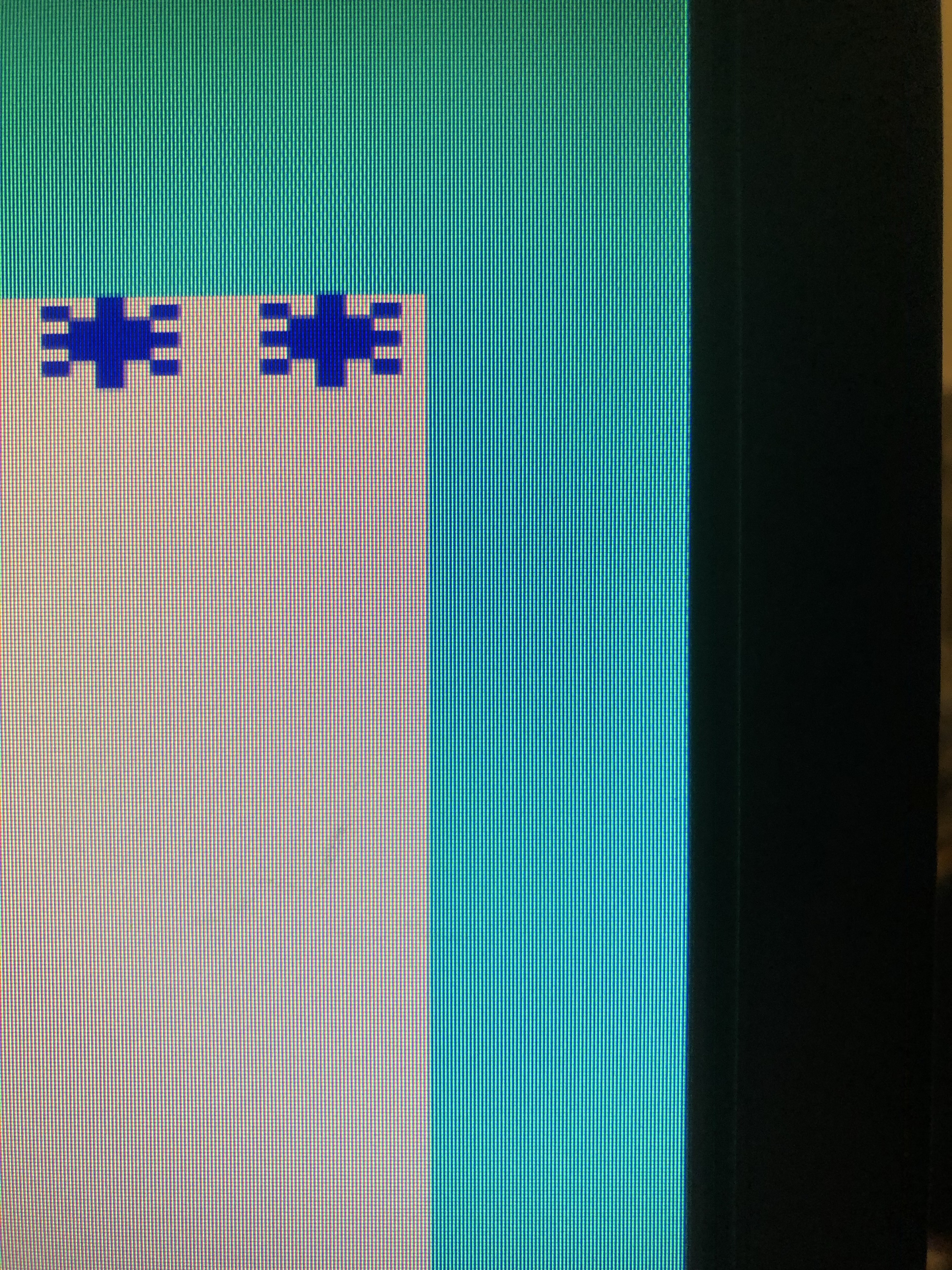

I finally got the last ugly bug out of the MMU. Here is a short video of the following code (I start the video with a Wozmon disassembly of the code before I run it):
Basically the "NOP $0022,X" precode is the new MMF $0022 bank select opcode. Using that before an access to $A000 results in an actual memory access of $22000. This works for all opcodes that can access the $A000-$AFFF memory area (but not for other memory areas).
The program starts by storing 256 zeros into $22000 to $220FF.
It then increases the memory location $22000 to $220FF by 1 using INC.
Third, the program copies the content of location $22000-$220FF onto the screen.
Last, the program copies the content of the screen back into location $22000-$220FF before it jumps back to the increase loop.
Everything here runs with IRQ enabled. The interrupt handling has taken some time to get going, but now seems to work. MMF opcodes are stored if an interrupt occur straight after, and is executed at the correct location once the isr returns to the program (through an RTI). And if you wonder: the program runs on the internal NMOS 6502.
