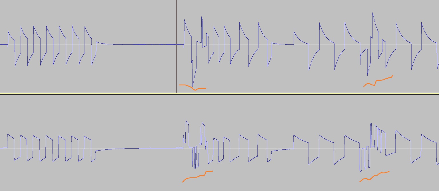

this is a point in DATAPOP (arount 7 seconds after the start) where the two waveforms are quite different.
Top: FPGA
Bottom: real VIC20
tlr
Posts: 594
Re: Noise generator implementation in VICE
Post by tlr »
Interesting differences there but quite hard to analyze as the bursts are so short.
I looked at the vhdl-code you posted in the vice bugtracker. Could it be that the logic of resetting and/or clocking the LFSR and circular shift reg is different than your model in the case of gate off?
From what I could tell the circular shift reg is after the LFSR. If that was to stop on gate off maybe some strange effects could arise, atleast for the start of the sequence. Also the LFSR seems to be '1' filled on gate off. This would mean the noise always starts the exact same sequence assuming it was clocked 16 times with gate off. Is that really so?
BTW: in datapop, the fifo that feeds values into the noise register is at $10c0-$10ff. There you can quicky see the register values used during a particular section. It's a circular buffer with the current offset stored in $bc. At $03a0-$03df the number of 256 cycle intervals to keep that value is stored (the current one is counting down in place).
