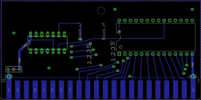

Re: Cartridge designs released - Eagle PCBs
In case you couldn't see the bottom layer here they are separated. The ground plane doesn't show in these images.

@norm8332
I can confirm to you, the 74_00 on this boards acts as a single AND gate and 2 buffers.
The main clue is the 2 pins (5 and 10) which are inputs to 2 NAND gates and connected to the 5V source on the bottom layer. This forces both of these gates to act as simple inverters.
If you do, I suggest you use very fast, low voltage drop diodes. I use 1N6263 on the Behr-Bonz, the resistor I use is 2.2kOhms.norm8332 wrote:I'll have to give that a try when I get a chance.

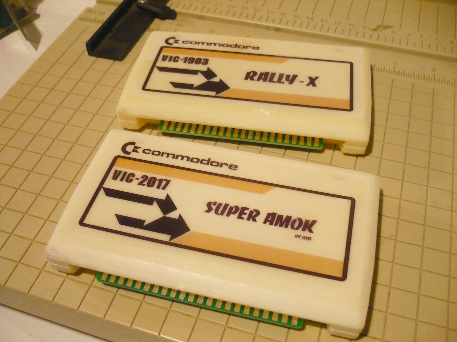

Finished a couple more I wanted to make.

Would you be interested in selling a few of those 3D printed cases ?norm8332 wrote:Finished a couple more I wanted to make.
They could be sold, but I mostly post 3D printed stuff as a promotion of 3D printing. It is a great thing for a person to take up as a hobby. I got hooked in late 2013 and built three printers. One thing you soon realize that while great for the hobbyist, it is not a money making proposition unless you charge insanely high prices. Sure the item may only have $1 worth of plastic, but its the large amount of work involved. For example with the Commodore carts, each takes about an hour of hands on time and over 2 hours to print. Then what you get in the end in no way resembles an injection molded part unless you spend another 1.5-2 hours sanding and painting it (I did this only on the BEHR-BONZeslapion wrote:Would be interested in selling a few of those 3D printed cases ?norm8332 wrote:Finished a couple more I wanted to make.
That's why I believe 3D printing is great for the Hobbyist only really. After buying a few 3D printed items, you realize you could have just built a printer for the same price.

There are 2 things that come to my mind.norm8332 wrote:... One thing you soon realize that while great for the hobbyist, it is not a money making proposition unless you charge insanely high prices. Sure the item may only have $1 worth of plastic, but its the large amount of work involved. For example with the Commodore carts, each takes about an hour of hands on time and over 2 hours to print. Then what you get in the end in no way resembles an injection molded part unless you spend another 1.5-2 hours sanding and painting it (I did this only on the BEHR-BONZ). Only then after up to 3.5 hours of hands on time and over 2 hours printing do you get something comparable. So if one were to charge a very modest $20/hr, the sanded/painted one including consumables would be over $70! And the non finished/flawed one would be above $25. Just for an empty, highly flawed (by injection mold standards) cartridge case! And add another $5 or more for shipping!
Back in 1991, I worked on Macintosh and Amiga computers doing desktop publishing and I was responsible for operating an Agfa Compugraphic 9400 imagesetter. It was an incredibly slow machine, just like your 3D printer.
Our solution was to offer mostly 24 hours service and charge a high price for 'Rush' 3 hours service which very few people used. When the shop was about to close, we would send all the day's imaging jobs to a printer spooler so the imagesetter would work all evening and night while employees were away. The jobs would then be sent to the developer machine in the morning and be ready before noon.
I assume you have a day job so the equivalent for you would be to get your printer to do its job when you're away at work. If you have 3 printers, then you can have 3 cases ready when you get back home and the amount of time taken is the time to start your computer and click 'PRINT' just before leaving for work.
The other thing that comes to mind is the fact that personally, I would much prefer a 3D printed case I am expected to sand and paint myself because I can then sand it to the level of my preference and I can elect to use special or ultra high grade protective paints you would probably not offer. Conductive nickel paint is an example.
Is the idea to solder something like this to the board:
https://www.ebay.com/itm/28-Pin-DIP-Mac ... 25bbd3af56
and then plug the eprom into it,
or just to solder the eprom directly to the board?
I'm thinking to fit it in one of those beautiful cases the eprom needs to burned/tested and soldered right to the board, no?
You can use a socket, but it will require that you shorten the pins on the eprom by about 2mm so it sits flush in the socket. You also have to trim the pins etc. on the solder side of the board. I recommend double wipe sockets. They are cheaper than machined and work fine. I've never tried the ones you linked so I can't tell you if they will work.
I have been just soldering most of them in since the EPROMs are currently less than $1 in a quantity of 10 shipped on eBay. They are refurbished (regardless of what the listing says), but they work. One time I did have to run some through an erase process before they would program. I'm guessing they were X-rayed at one point.

Ah.., burnt IC's are never any goodtoby405 wrote: eprom need to burned/tested and soldered right to the board, no?
I usually always put sockets because de-soldering is a pain. I use the cheaper flat pin sockets, but I might get criticized for that.
Anyway you still need to figure out how you will program your IC's.
