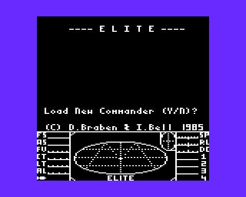

So, here's then my proposal for the screen/memory layout of a graphics mode in a VIC-20 ELITE port, which is only a little bit smaller than the effective 128x200 resolution in above props. It rather has 112x160 pixels, but the memory layout allows for page flipping in the upper cockpit view, with a single bitmap for the bottom scanner/instruments part:
  • $1000 .. $108B: "Text" screen 1 (top: $3C..$9D, bottom: $09..$1F, $29..$3B)
  • $1090 .. $11FF: Scanner bitmap 1st part (23 Characters, $09..$1F)
  • $1200 .. $128B: "Text" screen 2 (top: $9E..$FF, bottom: $09..$1F, $29..$3B)
  • $1290 .. $13BF: Scanner bitmap 2nd part (19 Characters, $29..$3B)
  • $13C0 .. $19DF: Cockpit 1st bitmap page (Chars $3C..$9D)
  • $19E0 .. $1FFF: Cockpit 2nd bitmap page (Chars $9E..$FF)
... which incidentally makes full use of the VIC-accessible RAM in $1000..$1FFF. :mrgreen:
Both cockpit bitmap pages form a continuous address space; as always, the addressing characters in the text screens should be arranged in a column-wise fashion. The scanner/instruments bitmap is discontinuous, but that's no big loss here.
A redesign of the view should probably dispense with the rectangle frame around cockpit and instrument view. IMO, the screen border is entirely sufficient for that (and could also indicate the alarm status: green/yellow/red during flight, blue while docked). It should be entirely possible to adapt the scanner/instrument view for the new size of 112x48 pixels (Edit: done, see below!).
The cockpit view then has a "square" 112x112 pixels, but the geometry engine should of course take the non-square pixel aspect ratio into account, which results in a 5:3 cockpit format for PAL and a 3:2 cockpit format for NTSC, both of which are a good match for the cockpit view rectangle dimensions in the original.
With 4x8 pixel characters, the resulting text screen (for the planetary descriptions, etc.) then only has 28x20 characters, which horizontally is just a little bit short compared to the 32 columns in the original. It should be workable still, with careful shortening of some texts (overlength text descriptions even appear in the original, ELITE then pages the text!).

I would hope that page flipping is not necessary with the improved line-drawing-routines and as such Elite can keep it's look and feel from the C64 / BBC-versions especially in the scanner/instrument view. If the line-removal-method from the BBC-master-version is also applied, which instead of first removing *all* lines and then redrawing all lines again, it just does this on a line-by-line basis, flicker show be minimal.
So my vote goes for the resolution as shown in the screenshots above by Aleksi.
Re: Let's bring ELITE to the VIC-20
The lower resolution in the upper cockpit view will anyhow be a tell-tale sign that this port does not run on a C64 or BBC.
With page flipping, there's a fixed cost of clearing the 'hidden' bitmap of about 8000 cycles (using STA ABS,X in an unrolled loop). Drawing a single line of, say, 60 pixels length (an assumption not too unreasonable for the title screen!) with my fast line routine takes about 2000 cycles. When there are more than 4 such lines on screen, clearing the bitmap is faster than undrawing the lines.
Here's how the title screen (sans Cobra Mk III) possibly could look like. The picture is aspected in NTSC format; as one could expect, the display in PAL will be a bit stretched horizontally:
(download, MG format, use at least +8K RAM and load with "...",8)
So then ... anything's amiss? :wink:
