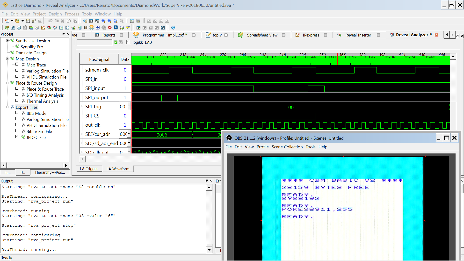

Some more updates:
I decided to use IO2 area as a DMA buffer for the SPI interface for the SD Card. It has been quite hard to get this working, but I finally got the SDCard to respond.
It may not look like much: What you see here are the actual signals on the SPI bus. At initialization, the SPI clock had to be slowed down, so it runs at 200kHz. The SPI output is composed from bits from data that is stored in the $9800-9BFF area (starting at $9800). What is really great here is that the SPI_input line goes high, then low (in the middle of the picture). That low signal (7 bits low, then 1 bit high) is the "acknowledged, idle" signal from the SD Card itself. Which is what I have tried to get for a week!
How this works:
SD Card commands are sent over the SPI bus using the memory from $9800 (and onwards for up to 1024 bytes). Since this is a DMA functionality, the 6502 starts the transfer by writing to $97FF (which is actually in the color memory, but unused since the screen only contains 506 bytes). The SuperVixen grabs the value that goes into $97FF and uses bit7-1 as length (bytes*8) and bit0 as directional register. There are also special poke values of 254 to set SPI bus into high speed mode (25MHz) and 255 to stop the SPI clock (and go back to init). All was made in Verilog to be as fast as possible.
Thus, memory transfer of 512bytes (normal FAT32 length) goes independent of the 6502 and at 25Mbit/s (=3,1Mbyte/s). At loading, the slowest part will be to copy the bytes from the buffer into the internal Vic-20 memory (around 100kbyte/s), while the expansion memory can use the 65C02 at around 2,5Mbyte/s.
All-in-all it means that a 28KiB program could (in theory) load from $1000 to $1FFF in 0,04seconds and from $2000 to $7FFF in 0,01seconds. E.g. in half the time it takes to display a frame on the screen. In practice, the SDCard may take some more time for certain tasks, but I don't think you are going to notice.
How this works:

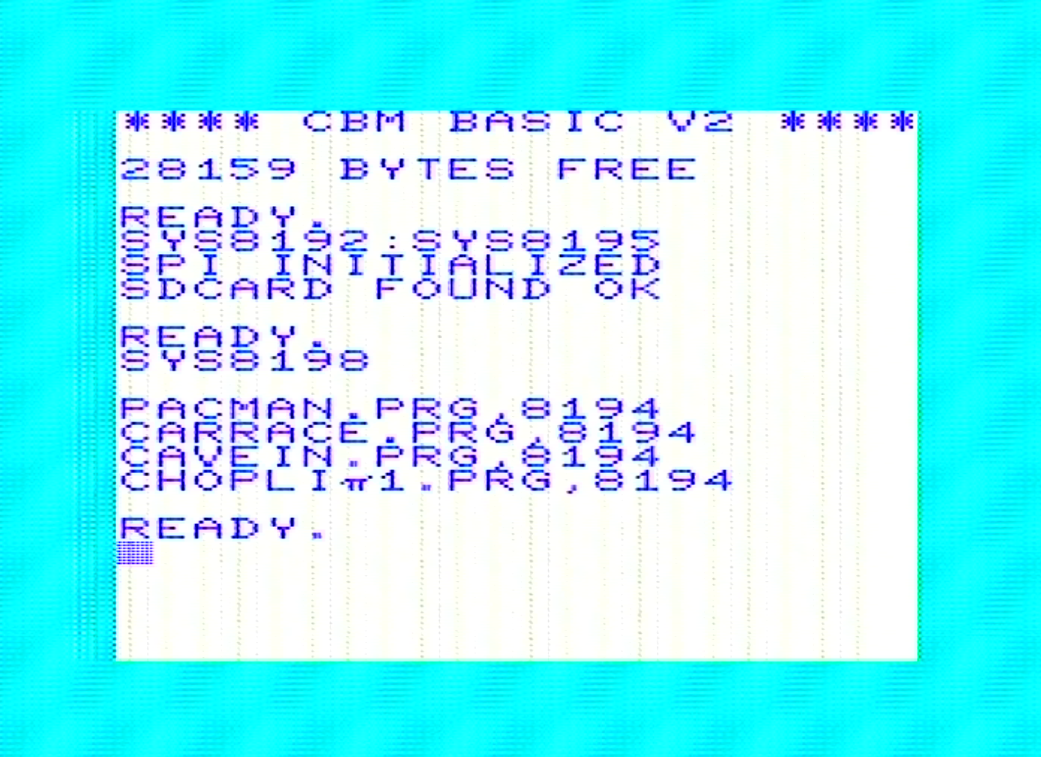

Short update:
After alot of debugging and correcting my own errors as well as bugs in the original code, I am now able to load and display the directory on the sd card. I still have a few problems to solve, but all the fundamentals seems to work.
Edit: Spoiler: Showing the 4 files currently on the card. All 8KiB ROM images with a two-byte start address at the beginning (hence 8194 bytes long). Later I will convert all files over 1023 bytes to show as KB.
Commands can be implemented in a number of ways.. but thats for later.
