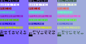

I've tried to make a palette file for VICE looking as close as possible to my vic-20 standing right beside the PC, so I can compare pretty well. I think I've got it pretty close. (You have to turn off PAL emulation in the options menu if you like to try it).
But what is the Dither value for? Anyone who knows?

VICE Manual wrote:DITHER is a 4-bit hexadecimal number specifying the pattern you want when rendering on a B/W display.
For comparison, this palette was derived by Pasi Ojala (Albert of Pu-239, VIMM etc). See also the slightly different colour definitions in the VIC-20 picture converter.

It appears the brightness is cranked up rather much on your monitor, so black is rather grey. Pasi may have made a decision that black is black and white is white (which is not true on a real VIC-20, at least not PAL) and adopted the other colours accordingly.
Not without reading the source code, but I believe PAL emulation calculates the colours based on gamma, shade, brightness etc. When using the default palette, PAL emulation looks somewhat OK, but as soon as you use a different palette, everything screws up so cyan turns light blue etc.
Btw, the color black can never become entirely black on an old TV or the Philips CM8833-II monitor I'm using, becuase the screen itself isn't black like it is on modern monitors. Maybe I have it set a little bright though, or my PC monitor is set darker than yours (which would result in a too bright palette).
