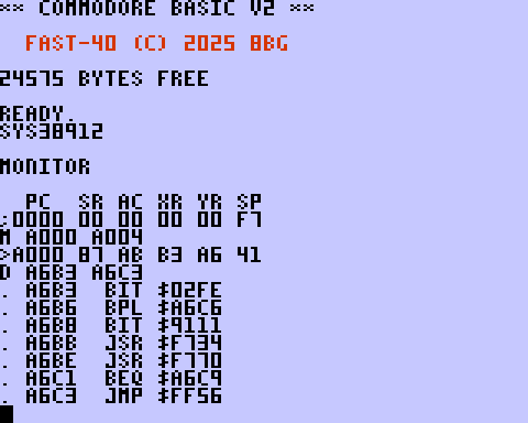

For the sheer fun of it, I tried out MINIMON in FAST-40:
It works! :mrgreen:
Moving the cursor back into the disassembly or into the hex dump does as supposed and lets the user change code or hex data.
When MINIMON has been started with SYS 38912, it superimposes its own idea where the BRK and NMI vector should point to, but it plays nice with FAST-40 upon STOP/RESTORE and lets it take precedence here, so the BRK and NMI vector are defaulted to the FAST-40 values.

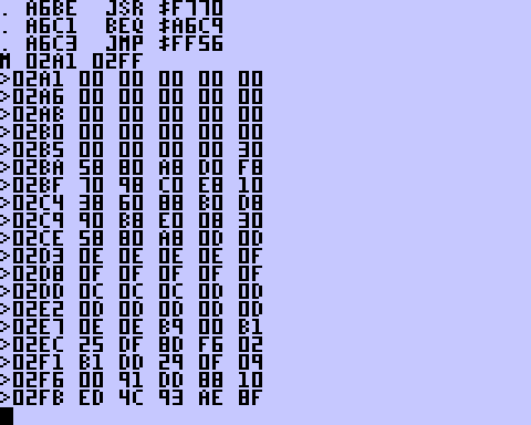

I have also found out FAST-40 makes good use of the buffer at $02A1..$02FF ... it's a good thing MINIMON leaves that one untouched:
