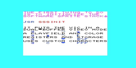

Hello,
i have updated the VIC-SSS with all my knowledge. :idea:
But, there is an error in the pointer to the memory location to the charset.
I can write the normal text, but some chars are not perform correctly.
I changed PrintScont and add $40 to the loaded value if the value is <= $80.
Maybee someone can help?
; Software Sprite Stack PRINT STRING FROM POINTER ON STACK
; Will print bytes, until a NULL, following the JSR call here.
; Carriage control and color codes are interpreted.
; Note that there is a limit of 256 bytes of data
SSSXYPRINTS
                PLA
                STA VECTORFG
                PLA
                STA VECTORFG+1
                LDY #$01
                LDA (VECTORFG),Y
                ;PHA
		STA PHL0
                INY
                LDA (VECTORFG),Y
                TAY
                ;PLA
		LDA PHL0
                TAX
                JSR SSSPLOT
                LDY #3
                JMP DOSSSPRINTS
SSSPRINTS
                PLA
                STA VECTORFG
                PLA
                STA VECTORFG+1
                LDY #$01
DOSSSPRINTS
PRINTSloop      LDA (VECTORFG),Y ;limits data length to 256
                BEQ PRINTSfini
                CMP #$0D         ; carriage return
                BNE PRINTSctrl
                ;TYA
                ;PHA
		STY PHL0
                LDY CRSRROW
                INY
                LDX #0
                JSR SSSPLOT
                ;PLA
                ;TAY
		LDY PHL0
                JMP PRINTSnext
PRINTSctrl
		CMP #$F0
                BCC PRINTScont               		; color code?
                AND #$0F                			; filter for 16-colors
                STA COLORCODE   			; 0=blk,1=wht,2=red,3=cyn,4=mag,5=grn,6=blu,7=yel
                JMP PRINTSnext
PRINTScont
				CMP #$80
				BCS yesprint
				ADC #$40
yesprint:
		JSR SSSPRINT
PRINTSnext
		INY
                BNE PRINTSloop
                INC VECTORFG+1
                BNE PRINTSloop
PRINTSfini
		TYA
                CLC
                ADC VECTORFG
                BCC PRINTScc
                INC VECTORFG+1
PRINTScc
		STA VECTORFG
                LDA VECTORFG+1
                PHA
                LDA VECTORFG
                PHA
                RTS
