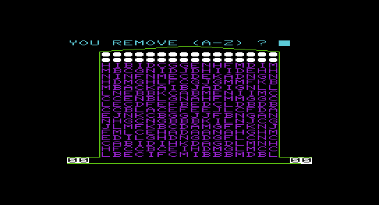

To move, type the letter (a-z) you wish to remove and the balls will cascade down the gaps left. on reaching the bottom they will add to your score. The computer tries to do the same. The game ends when there are no balls left.
