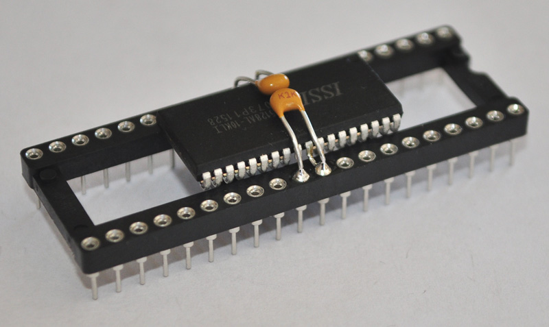

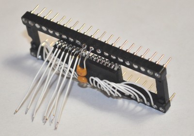

How did you fasten the RAM chip to the socket? Is it just the soldered wires or did you glue it?
Neat idea, BTW. I've seen that done before. Along with stacking several RAM IC's on one socket and separating the chip select signals.

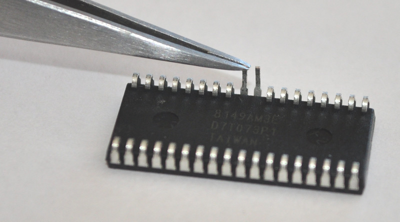

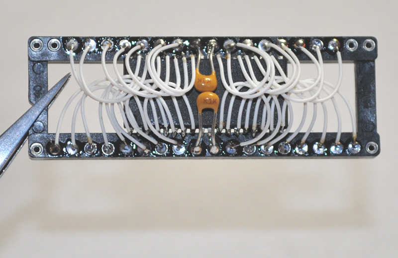

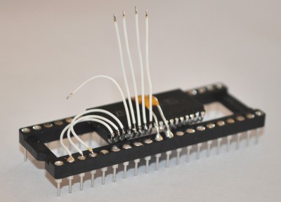

I like the stacks as well, and they are certainly less work.

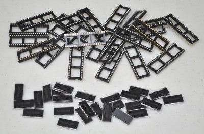

For this project, I wanted to make future repairs easier, so I decided to socket each SRAM.
In the end, I may have 32+ SRAMs on the board, and plan to stock pile many more so I can keep this unit in service for the rest of my years. Same goes for all of the 74 logic ICs
I will explain how I soldered 25 SRAMs to their sockets with photos.
This took me one 2 day weekend when I was battling a flu...
Shown above, is 12.5 Megabytes of 8 Bit, 10 Nanosecond SRAM.
Or as it will be in my system, 6.25 Megabytes of 16 Bit SRAM.
My Video Bus will have 24 Bits of address space for a total access of 16 MB.
Since I am doubling them up for 16 bit output, I need 4 ICs for aver 1MB of 16 Bit space.
To utilize the entire address space, I would need to solder an additional 30 ICs!
Not sure how many the final design will actually use yet, as they are scattered around for various systems.
Video Buffers, Sprites, Playfield, Sounds, Song Data, ASM Code, Vic Expansion, Compiled Code, etc.

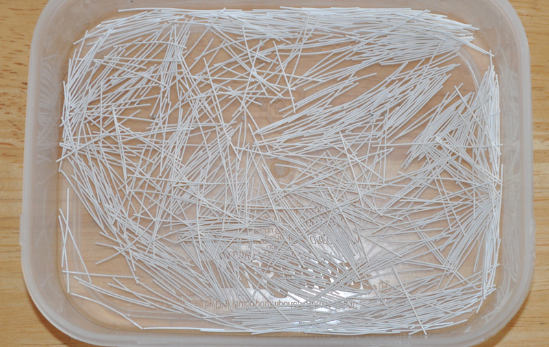

And that's all there is to it.
900 tiny wires, and a bit of patience!
